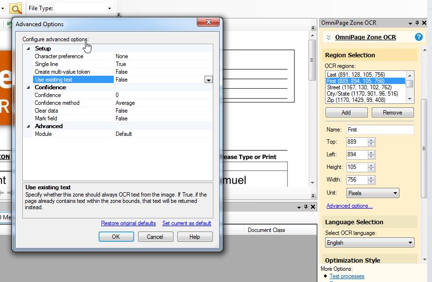

I'm not in front of my work computer right now but I know I've used "use existing text" in a zone OCR so that the "zone" I select is not being re-ocr'd.
From the help files (http://www.laserfiche.com/support/webhelp/quickfields/9.0/en-US/quickfields.htm#Processes/ZoneOCRAdvancedOptions.htm?Highlight=use existing
  • Use existing text: This option specifies whether the zone should use existing text or OCR text from the image. If True is selected, it will check and see if there is any text associated with the image (from OCR, Laserfiche Capture Engine retrieving text, or PDF generating text). If there is no text, it will be OCRed and returned. If False is selected the text within the zone bounds will be OCRed and used.
I find this option immensely useful because I can look for a specific set of words in a specific area of the page. Using whole page text matching is much less useful if the words you have are words that may show up in other locations as well.
Edit: Here's a screenshot of the setting in Laserfiche
