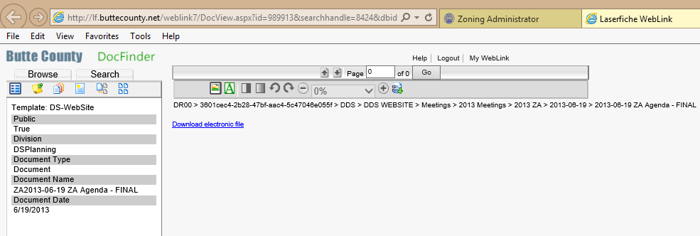

For example this is what limits us: http://lf.buttecounty.net/weblink7/ElectronicFile.aspx?docid=989945
I know I could do a search that would return the 1 document, but then it shows that extra step of clicking the "Download electronic file", which is an extra click.
