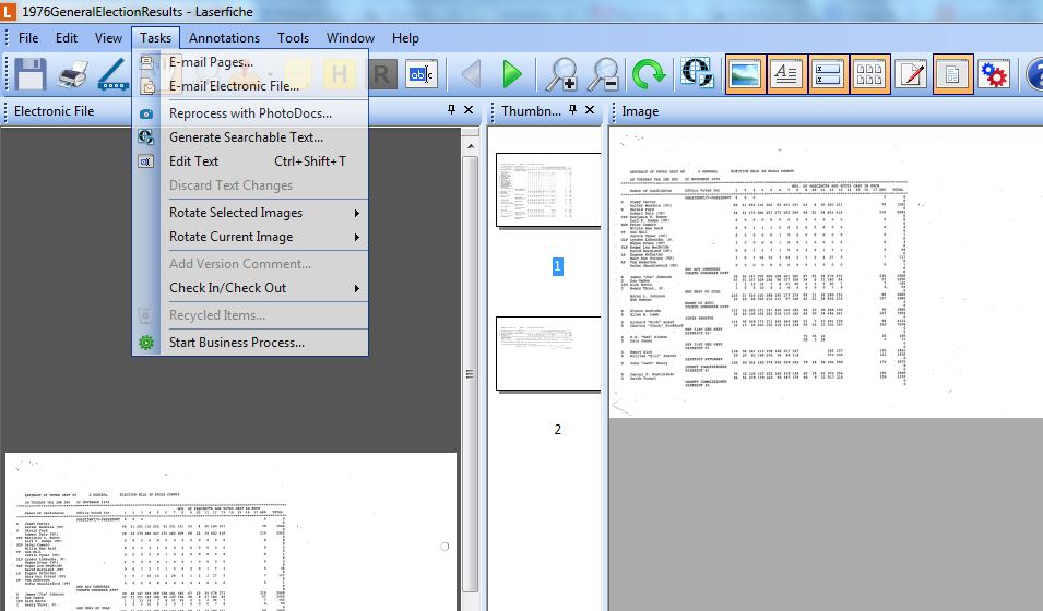

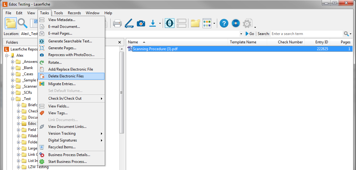

You can definitely convert PDFs into Tiffs in Laserfiche. Just follow these steps:
1. Select the desired document, right click and select generate pages if you haven’t already.
2. At this point the Tiffs are generated though the PDF component will still be there.
3. To remove the PDF component completely, go up to Tasks in toolbar and select delete Electronic Files.

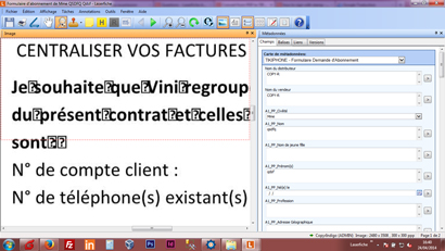

Hi,
When I try your solution, I have garbage characters. [?]
Why et how to resolve this problem ?
Regards
Olivier, please open a support case and attach the PDF.
https://support.laserfiche.com/CaseTracker.aspx?CaseId=160304
How did you fix this?
That specific case was resolved by regenerating the problematic PDF.
If you are using Snapshot to generate the pages from your PDF, try the resolutions/workarounds in this KB: https://support.laserfiche.com/kb/1012815/images-may-contain-invalid-characters-when-using-laserfiche-snapshot-to-generate-image-pages- .
If neither helps, you may need to open a support case so that Support can look at your specific problematic PDF.

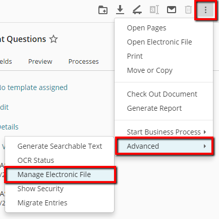

We just upgraded to Laserfiche 10 Web Access. I could not find Delete Electronic File.
Please advise. Thanks!
