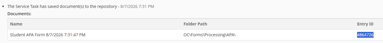

I'm trying to research a document.  When I look in Forms at a report of instances run I can find the completed form.
The document saved successfully in the repository and I can find it when searching by the Entry ID.  I can see that the workflow ran on it and completed.
But when I search in Workflow to see all of the processes for Entry ID 4864726, the search results are empty.
What am I missing?  What is preventing me from seeing the process history of this document in Workflow?  These steps work for other documents, but not this one.

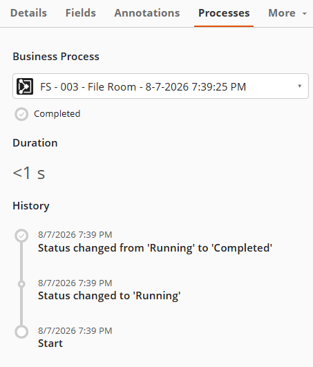

Search WF for all that ran on 8/7 (per your pic above). Then sort it on start time and manually look for all the WF's that ran at 7:39 PM (per pic above). See what you can find there. If you find it, see if that entry id appears on the 'Entries' tab on the run WF. Good luck!
