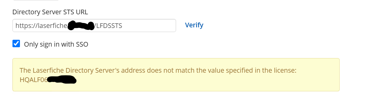

When clicking verify we get this error
This server name mentioned HQALF06 is an old LFDS server and this is not the server that produced the license. We can open the license in Notepad and clearly see this. Why does it bring up a name that does not exist in the license?
We can login, so the license does work. I recycled the app pool, replaced the license multiple times, it always gives this error.

It isn't an error, it is informational. Are you able to find HAQ1ALF06 in the license file at all? We changed our LFDS server a few years ago and the license files still reference that original server. Everything works, but it's strange that it is referenced.

The license file does not show it. The license file was created from the new server name, after the name change because I learned the hard way what happens if you don't re-download and replace all the lf.licx files
