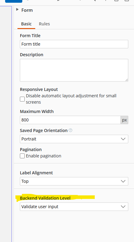

Have you checked your Form settings-> backend validation? It might be set to validate user input or validate all, then it means even it can be sumitted, Forms will check the submission data again. Could you check?

This is controlled at a Form level, in your Form, you should have a settings tab, and there wil lbe Backend Validation Level to set. e.g. for the modern form designer, classic form has its settings page per form too.
