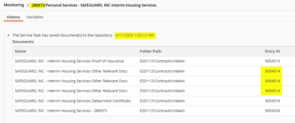

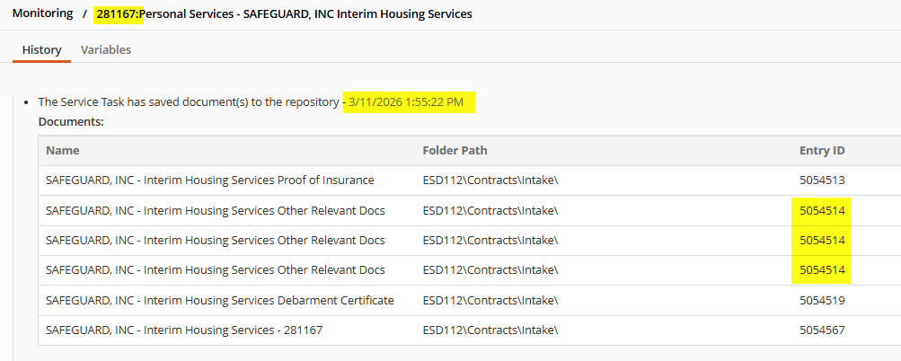

Why are we seeing the exact same entry ID in multiple instances? That's one. The other question is why there are the exact same entry ID showing per instance? One instance was cancelled which is interesting.
These are from a cancelled instance:
This one completed successfully:

Hi Chris,
I just did a simple test by starting two instances and upload same attachment, but they are saved to repository with different names, one has (2) as suffix, the Name Conflicts setting is same as yours. Can you tell how many instances are showing the same entry ids? And for those instances, the attachments are saved indeed with (2), (3) after names, or not saved at all? The files list you see is stored in Forms database, you can use the query to get the history data for the STR step.

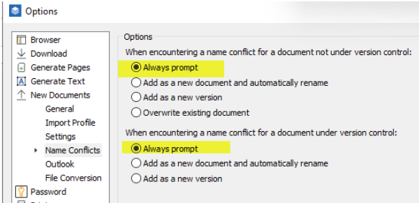

replied on July 8 • Show version history
@████████, just to confirm. You set your save to repository user like this, correct?
replied on July 9
Yes, but I should have replied in the support ticket, this is windows client setting, it does not affect how Forms save to repository, cause Forms doesn't support read this setting yet.

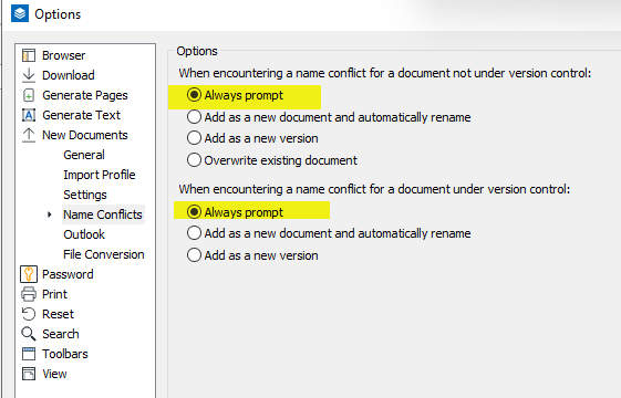

replied on June 30 • Show version history

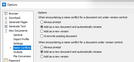

Best bet is that this setting in the save to repo profile user is set incorrectly:
and needs to be:
Does this check out? Or is this  bug? Shouldn't every time an instance saves to the repo a new entry ID gets assigned? Unless this is an exception. I need some confirmation that this is expected behavior please. This issue has the natives shook up pretty well over here.

replied on July 1
This is just looking at the history in Forms. Have you checked that entry ID in the repository to see if that's the case? From the screenshot, is it possible that the same doc, therefore same entry ID, was processed multiple times, then just saved in the repository with different entry IDs or just saved only once because of the naming conflicts?
I also believe your name conflicts changes would be correct. If it's an automatic process, you don't want the repository to prompt you or it will fail.
replied on July 2 • Show version history
Confirmed. The same entry exists once in the repository and was saved by more than one Forms instance. The prompting did NOT make it fail. Rather it ignored the prompt and moved on.
