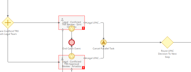

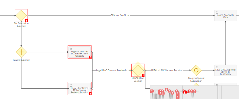

i have a parallel gateway that splits a task between two approvers. Either of the two can approve. Once one approves, then the process flows to the next step and the  other task is closed to the other person is closed. How can i configure this scenario on the process canvas in Laserfiche Cloud.
Attached is my current set u and the process keeps terminating once one person approves.
Please help possibly with process flow map.
Thank you

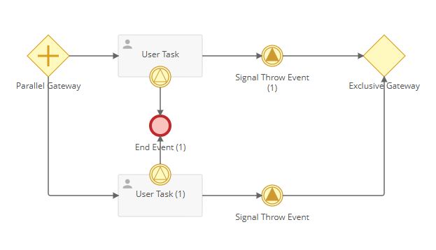

You can use a Signal Throw even to stop the other task. Design would look like this.
The Signal Catch on the Task is set to Interrupt. Who ever finishes their task first will hit their signal throw which would be caught by the remaining running tasks. Although their are 2 throws and 2 catches, you only need to create 1 signal.

I tried the following using 1 signal event and got the following error:
Routing cannot be split to any subsequent branch. XPath evaluation may fail for every possible condition. [LFF5408-RoutingConditionMayFail]
Below is the process map I set up.
Am i doing something wrong?
replied on June 25
Hello Steve
Finally got it to work using your exact process map.
It didn't work with a single signal however. May be i didnt do it right though.
Thank you so much.
