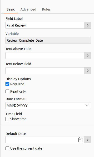

Okay I took a moment and just deleted all the code out of my current form (saving it aside of course), and the error still shows up in console whenever the date field value is changed.
Screen shot of the settings on the date field... the other tabs are just the default settings.
replied on June 29
I believe this is a bug and reproduced it myself, this is reported as bug #677805, it only happens when you set Required on Date field. non-required date field are not affected. But it does not seem to affect the value of the field, just the validation breaks.
