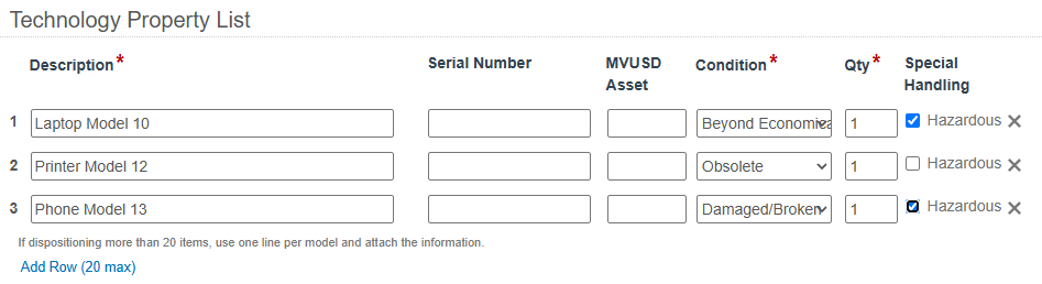

Hello, I'm having trouble trying to get a checkbox within a table inside Forms to go into Workflow Fill Out PDF those checkboxes. I'm aware some people mistakenly use Checkboxes instead of Radio buttons but I think my use is correct.
This is what the Form looks like, the check box is the last column for Special Handling / Hazardous:
The field option I have for the checkbox is "Yes"
The PDF export value for the checkboxes is also Yes, and each checkbox is a unique numbered Field

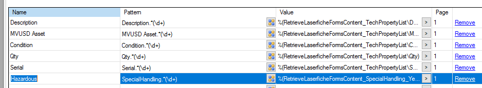

This is the Fill Out PDF Table in Workflow:
Note that the other fields in the table works fine. The Value is: %(RetrieveLaserficheFormsContent_SpecialHandling_Yes_Is Set)
With all that, the Checkboxes aren't being checked when selected in the Form, anything I'm missing?

I haven't done this myself, so just guessing here based on your token, but you listed this token:
I believe that token is going to return True or False based on whether or not the checkbox is marked, not the actual value of the checkbox.
There should be a different token to return the actual checkbox values:
%(RetrieveLaserficheFormsContent_SpecialHandling)
Of course, if your checkbox field has more than one checkbox included, you're going to get a list of the selected boxes, not just one.
And as I mentioned, I haven't done this myself, this is just a guess, I could be way off the mark.
