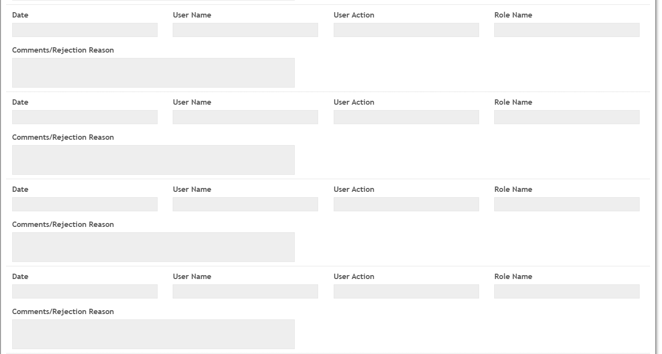

I am facing collection issue on forms where values getting from workflow tokens. I am trying to delete blank rows from edit variables but not success, blank rows appeared on forms in collection. Kindly refer screenshot which blank rows populated.
Please help me to resolve the issue.

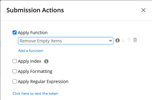

Is your Collection set to Rows or to Append Data in the Advanced Tab
Can you show the workflow that is creating the Output Tokens for this table.
One idea could be to apply to the Token Editor>Apply Function>Remove Empty Values to the Output Token

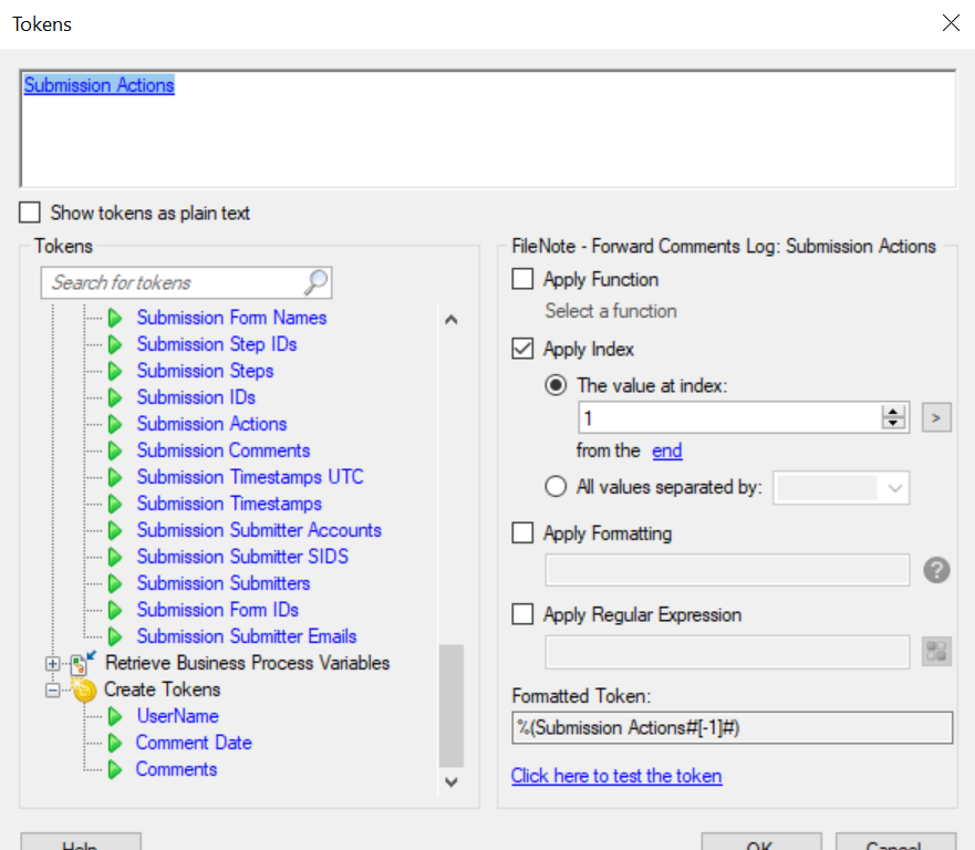

Hi Steve,
Thank you for your reply. I have fixed the workflow tokens issue after that error occurred. I have set the apply index function to remove empty values for that particular tokens. Please find screenshot where i done the changes in tokens.
Please let me know how i remove blank rows from running instance.

I was thinking this, does your work?

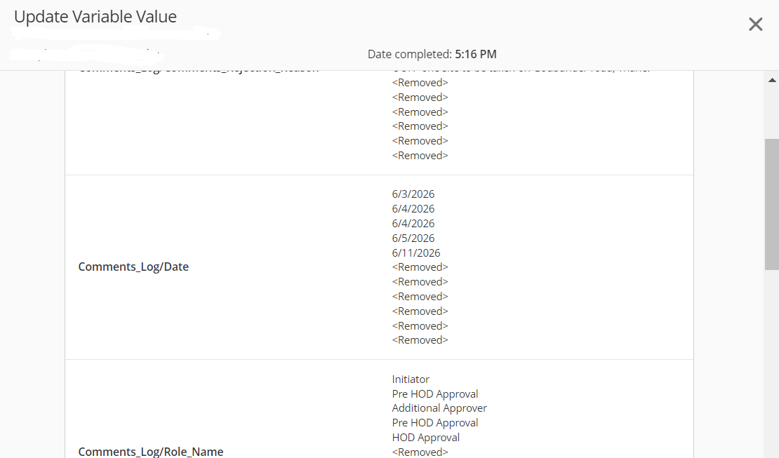

In regards to the running instances, basically you would need to edit the Variable data in the BP Monitor for the running instances.

This function is not showing in workflow tokens.

I had already done the edit variables from BP monitor for running instances but not success. At this moment, i am touching the running process to modify the BP.
