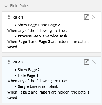

I've made a simple test form with 2 pages, one single-line field on each page. This is what I was testing with. With this field rule, as we mentioned, it will hide both pages when we try to fill out the form because we are not at the save to repository task.
I also tried Rule #1 being show both pages at our Save to Repository step and Rule #2 being show page 2 and hide page 1 when Single Line is filled in, but that does not save both pages to the repository. It only saves Page 2.

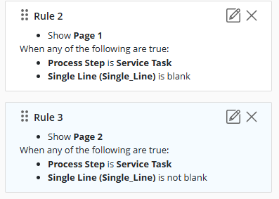

You need to do a combination with your rules:
Instead of trying to get the different rules to apply in the same rule, split it up and add various rules.
replied on June 16
Thank you Angela! This has worked with my test form, and I don't see why it shouldn't also work with my production form as well. I will need to test tomorrow to confirm, but am marking this as the answer regardless.
