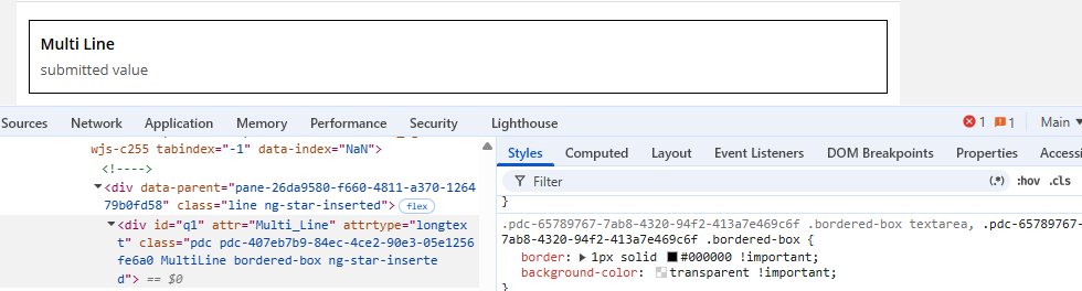

Can you check on a submitted form in your environment, inspect on the webpage and see how the style is applied on the html element?
This is what it should look like:
