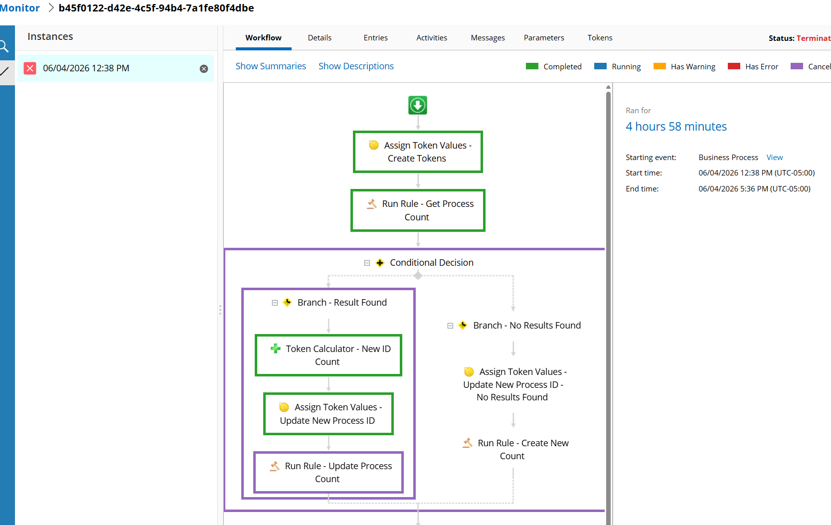

We recently had a Laserfiche Cloud workflow instance remain in a running state for approximately 3 hours without completing or generating an error. Under normal conditions, this workflow completes in approximately 10 seconds.
The workflow itself is pretty simple. Its primary purpose is to generate a custom Process ID for a given Business Process by reading a value from a Data Management table and incrementing a counter on the appropriate row. The table contains fewer than 30 rows and the workflow performs only a read and an update on one row.
After seeing that the instance kept running for a few hours, I immediately "re-tried" the workflow using the same process context and inputs. The new instance completed successfully in its normal 10 second timeframe without any workflow changes.

This was likely caused by one of our servers running out of resources on 6/4. We're looking at potential solutions for mitigation.
As a side note:
  • Workflow is not synchronous, so near real-time execution is not guaranteed. Depending on load on the account, workflow instances may queue up
  • If this ID is generated by reading a a value from a table and adding 1, the values are not guaranteed to be unique. 2 (or more) workflow instances may read the table at the same time, which would result in them generating the same ID value.

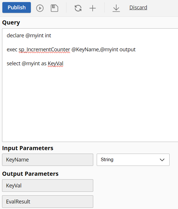

Is there a way to garuntee sequential number generation within LF? I presume a remote REST service could be create and and designed to protect against collisions. Other than that, reading from the LF table, writing the metadata, then checking the table for duplicates could also help prevent collisions. Loop and repreat until success. A bit messy though.
replied on June 9
Remote web service would do it. Calling into an external SQL to get the value from a sequence will also work as SQL will handle concurrency.

Miruna,
it works a treat!
