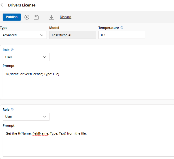

replied on May 14
Hi Jake,
When using files in an AI Prompt Rule, you'll get best results using an Advanced Prompt and splitting the File Token and the question into separate prompts.
So in that case it would look like
When run like this it should be able to retrieve the data from the Driver's License
-Kevin
replied on May 14
This is the way to go, thanks!
