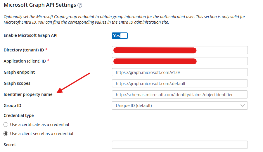

I'm struggling to get this properly setup. The documentation is not very clear on what property is responsible for what. Working with a SAML Identity Provider. We are LF 12, latest and greatest version (Laserfiche Directory Server 12 (Build 12.0.2603.369)).
We do have some users that have more than 150 groups tied to them, so we'd like to set this up so that it's able to retrieve the list of groups so that they can be associated to the proper LFDS group based on the SAML group ID (coming from Entra). Can someone explain what "Identifier property name" means, as I'm curious on how the link is done between the user logged in and Entra.

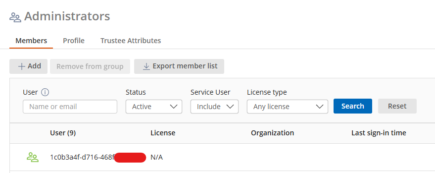

Then if we are pushing the group object IDs, is the proper setup to configure the LFDS group like so? (Add SAML Group with MS Entra group ID)

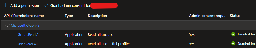

Our current MS Entra application has this configured as permissions, but not sure if there's other settings that need to be set as well (like claims)

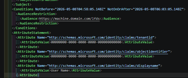

When you inspect the SAMLResponse EntraID post back to LFDSSTS, you will find something like
This attribute is telling LFDS that it should use value of "http://schemas.microsoft.com/identity/claims/objectidentifier" as the identity to query in EntraID.
(List a user's memberships (direct and transitive) - Microsoft Graph v1.0 | Microsoft Learn GET /users/{id | userPrincipalName}/transitiveMemberOf)

And since you enabled SCIM2.0, that might sync groups to LFDS, can you confirm that group (id: 1c0b....., name: XXXX) are not synced to LFDS?
replied on May 21
So upon visiting that page (/LFDSSTS/ClaimsTest), all the expected groups are not in there because in our MS Entra environment, we said only push the groups that are assigned to the application. So the users that should have access to the platform through the assigned groups, and only those groups are coming through the SAML token. I confirm that group in my example is not pushed to LF through SCIM.
