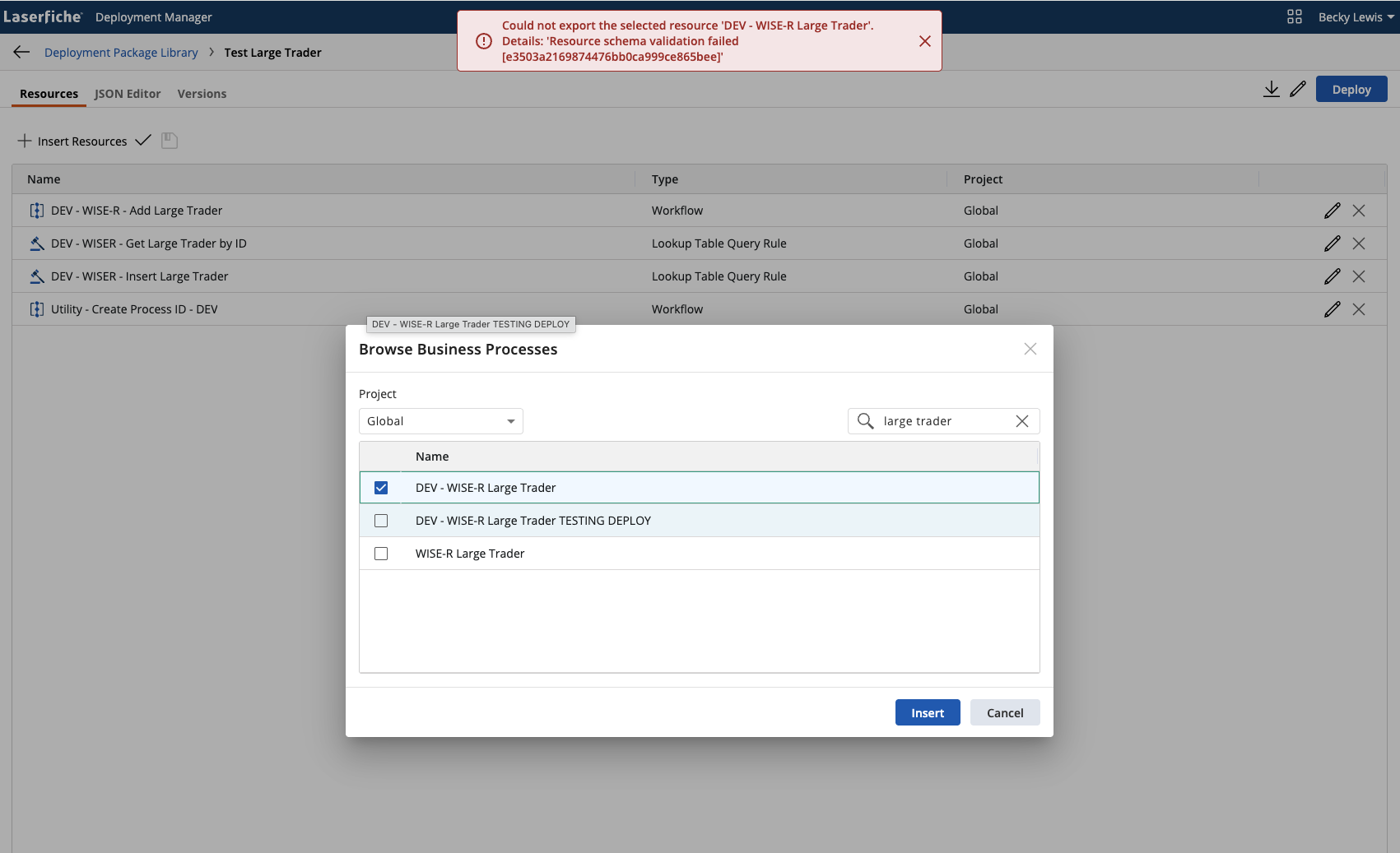

I'm encountering an error when attempting to add a specific business process to a Deployment Manager package in Laserfiche Cloud.
During an earlier deployment attempt, the package deployed successfully but landed outside the intended target project. I deleted that package and started fresh rather than modifying it, so I no longer have the original package for reference. I'm wondering if the business process got messed up in the process. Has anyone ran into this before?
Steps to Reproduce:
  1. Created a new Deployment Manager package
  2. Attempted to insert the business process
  3. Received the error below (all other resources — workflows, rules, etc. — were inserted successfully)
Error Message:
Could not export the selected resource 'DEV - WISE-R Large Trader'. Details: Resource schema validation failed Error ID: e3503a2169874476bb0ca999ce865bee
The Error ID appears to be unique on each attempt.
Expected Behavior:
The business process should insert into the deployment package without error, consistent with the other resources.
replied on May 6
Can you double-check your process. If it has any input or output parameters that are blank, please remove them and try again.
If the error persists, contact your reseller to open a case with Laserfiche Support so we can take a closer look at the process.
