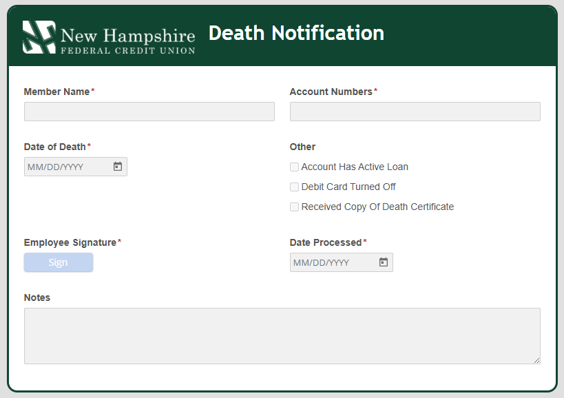

I have a pretty simple question but for the life of me i cant figure out the answer.
I have a form that needs to Go to our Accounting department but it will also need to go to our Collections department if a specific check box is checked off.
The form will always go to accounting no matter what check box is checked, but it  will only go to collections if the active loan check box is checked.

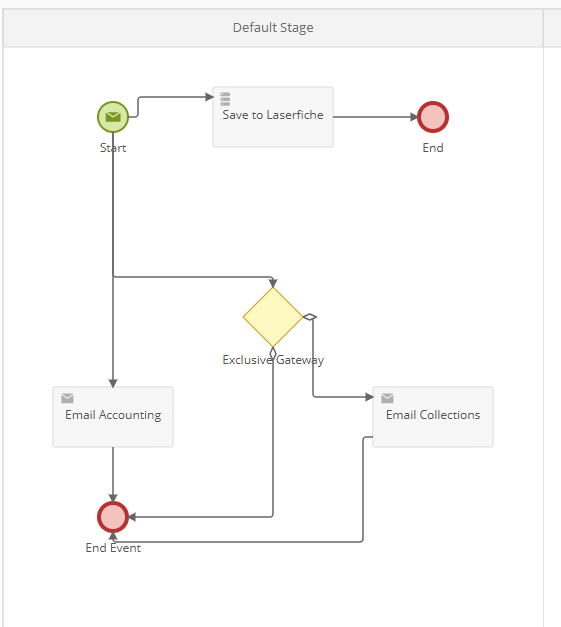

Thanks for all the Ideas, I was able to figure it out. Like i said this flow is very simple.
So attached is what i came up with.
Chris

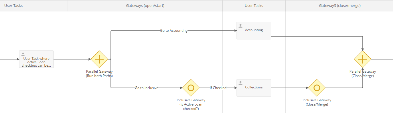

replied on April 16
I believe you want a Parallel Gateway leading to Accounting (runs every time) and also leading to an Inclusive Gateway (runs dependent on checkbox).  I'll include a quick mockup below:
