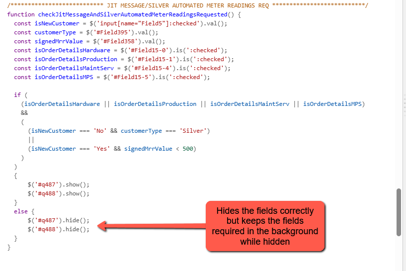

We have some code in the Javascript tab to hide some fields under certain conditions. The fields are listed as required on the form. When they are hidden via the javascript rules, they are correctly hidden from a visual standpoint, but the form seems to still think they're there (and thus required), rendering the form not submittable.
When using Javascript to hide a required field, does anyone know how to make the fields unrequired when hidden?

You either need to change the Validation Level of the form or reverse it so that the form field default is not required and use JavaScript to make it required based on your condition.  So instead of hiding it, show it and make it required based on the necessary conditions.
replied on March 27
That is correct. In Classic Forms, hiding a field with JavaScript does not automatically remove its required validation.
The usual fix is to make the field not required by default, then use JavaScript to both show/hide it and add/remove required at the same time.

So the key is: hiding the field is not enough by itself. If the field is hidden, remove required; if it is shown again, add required back.
Also, if those fields are already marked as required in the form designer, I would remove that setting and let the script control the required state instead.
