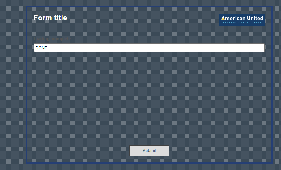

One problem I'm having is the appearance.
The progress bar appears on an entirely blank page, and after it loads, I have a form that is completely blended into the background.  Your example form is just a solid white page with the form fields on it.  When I tried to do my own form with my own theme, the form ended up being transparent to the background.
Progress bar loading:

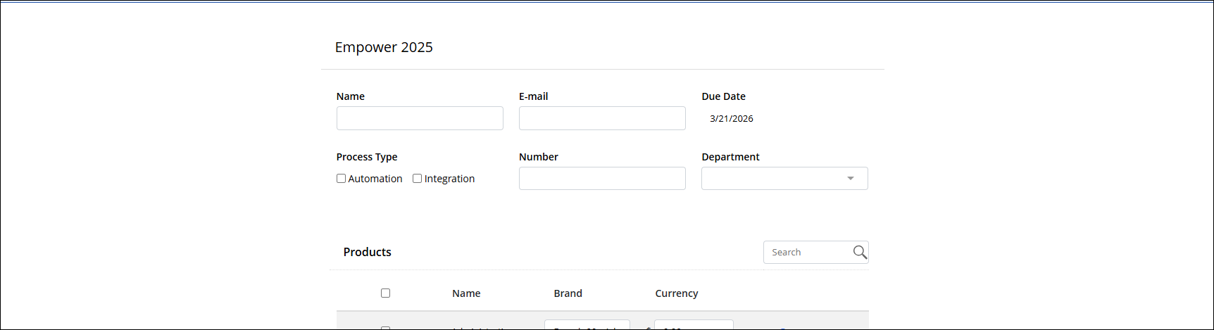

After load, you form is just the fields on a white page.
My form with my theme has a transparent background, so with the texture background the form is useless.
It's messy, and I haven't had any luck making it work with any of my themes.

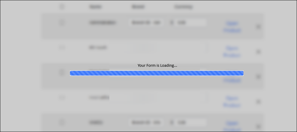

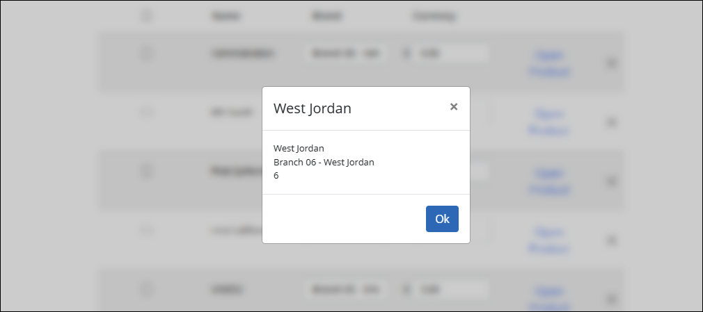

I really like how the modals work, where the modal is in front of the form, but the form is faded out.
I'm wondering if there is any way to make the progress bar appear like this modal, in front of the form, but with the form faded out.
Here's a mock-up of what I'd like to try to do:
And ideally, I'd like to be able to trigger this to show and hide on demand through Javascript.

If you're using the example form I built, there's loading html in the form description so that it shows up immediately and doesn't wait for any JS. That might be the source of your problems.

The issue with the background color was related to the functionality including the "use-background-color" CSS class.  But I think that was more about the appearance you were going for with the example form than what was needed for the loading bar, so I'm not even going to include that.
After digging deeper into this code you posted here, along with the CSS from the whole form you had shared before, and some browser inspection with the modal and how it was working, I have settled on some code that is working the way I want.
If I use the code you posted, I can add some additional code to call your function to add the progress bar, and another bit of code to remove it as needed.  The extra styling I want for the blurred background is included here too.
Here's the additional code.
//Add the loading bar on demand:
const loading = generateFullFieldHtml(
                  makeLoadingBar(100,{
                      text: "Loading your form",
                      styles: "padding-left: 35%; padding-right: 35%; min-width: 30px;"
                    styles:" position: fixed!important; background-color: rgba(0, 0, 0, 0.2); backdrop-filter: blur(5px);"
LFForm.changeFormSettings({description: loading});
//Just for testing - runs after 5 seconds:
setTimeout(function() {
  //Remove the loading bar on demand:
  LFForm.changeFormSettings({description: ""});
}, 5000);
