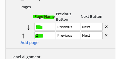

I verify myself sometimes too.
Since you are combining everything to a 4th copy you can just remove the Page Name from the Pagination area.  If you add a space in that box, it will let you save it.
The first form I tested on had a lot of unique scripting in it and I think I somehow hid pagination from printing on accident because when I added it, the headers did not print.  I used a different form and replicated your issue. I'm not sure what is preventing the print in my first form.  Removing the pagination page names worked just fine and was the easiest solution.

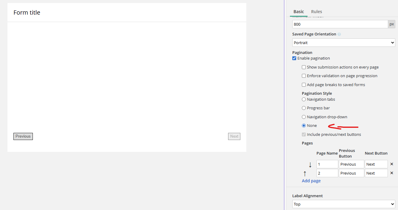

Luis -
I do have none selected for Pagination Style.
I am going to try your 2nd option! Hopefully that is the ticket.

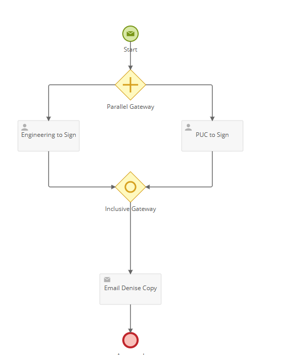

I have "using current process data" and then 4. Final Copy.  Below is my process diagram. Pretty simple / straight forward, however will probably add context to my question.
replied on March 9
Not that this has anything to do with your current issue, but you will want to replace the Inclusive gateway with another parallel gateway to close that out.
replied on March 9 • Show version history
If I use a parallel won't it close the process once one of  branches complete? Both branches do need to be completed before the email is sent.
replied on March 9
No.  Both paths have to close for it to continue:
Parallel Gateways
Parallel gateways split one process flow into several, or merge several flows into one.
Splitting parallel gateways
When a parallel gateway splits one process flow into several active paths, it represents an "And" decision, meaning that each outflow path will be taken. As a result, conditions do not need to be specified for a parallel gateway's outflow paths. This gateway is similar to the Parallel activity in Workflow.
Merging parallel gateways
When a parallel gateway merges several process flows into one, it waits for each incoming path to reach the gateway. Once each incoming path has reached the gateway, its outflow path will be taken.
replied on March 9
Thanks!  I swear every time I read about them I read them differently (I look it up all the time to confirm the best one)! I will go in and fix that and change it to a parallel.
replied on March 9
Awesome! I thought I tried that but didn't have spaces in the name! It works and this will be perfect for the this use case!

replied on March 4 • Show version history
Hi, are you trying to select the None option under Pagination Style?
