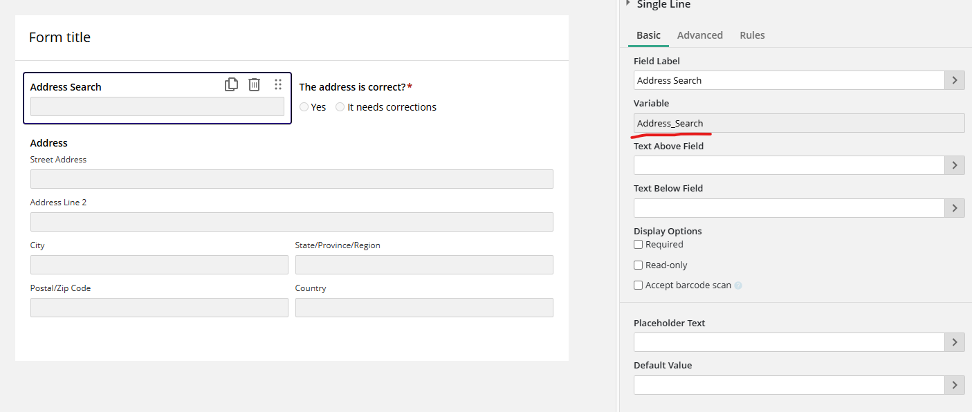

Hello everyone,
I recently worked on integrating the Google Maps Places API for address autocomplete in Laserfiche Modern Forms, and I wanted to share a working approach and explain a specific workaround that is required to make it function correctly.
I'm sharing this in hopes it helps someone else, but I am also very open to feedback. If anyone in the community has found a way to improve this solution, or if you've successfully managed to hook Google Autocomplete directly into the native Modern Forms Address block without running into these React conflicts, please feel free to share! Better approaches and optimizations are more than welcome.
The Challenge with the Native Address Block Initially, the goal was to attach the Google Autocomplete dropdown directly to the "Street Address" sub-field inside the native Laserfiche Address block. However, because Modern Forms is built on React, it aggressively manages the DOM, state, and input events.
When you try to hook Google's native UI directly into the Address block's sub-field, React's internal event handling clashes with Google Maps. This results in the dropdown list either being hidden, failing to trigger when typing, or the input freezing entirely. Furthermore, the dynamic IDs in Modern Forms make it very difficult to reliably target that specific sub-field.

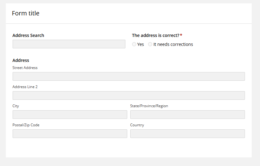

The Solution: The "Proxy" Search Field To achieve a smooth and fast user experience without fighting the React engine, the best solution is to use a separate Single Line text field as a dedicated search bar.
Here is how the flow works:

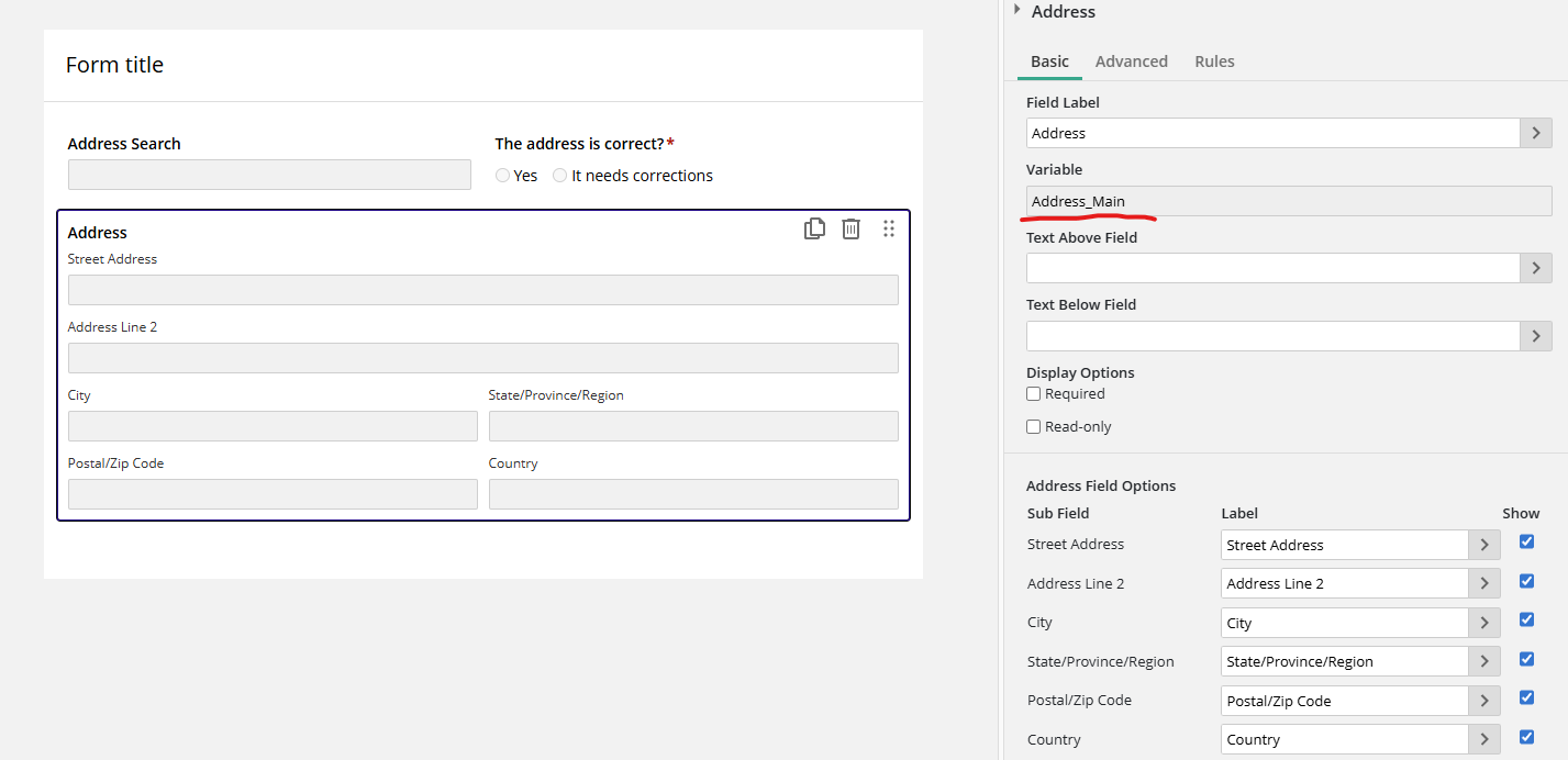

  1. Create a Single Line field (e.g., Address_Search) and place it right above your native Address block.
  2. Attach the Google Autocomplete script strictly to this Single Line field. Since it's a simple text input, React doesn't interfere with Google's UI, and the dropdown appears instantly as the user types.
  3. Map the Data: When the user selects an address from the Google dropdown, the JavaScript captures the Google Place object, parses the components (Street, City, State, Zip, Country), and maps them to Laserfiche's format.
  4. Auto-Fill the Native Block: Finally, the script uses LFForm.setFieldValues to silently push the formatted data into the actual native Address block (e.g., Address_Main) in one go.
This approach completely bypasses the React DOM conflicts, keeps the code clean, and provides a seamless, real-time autocomplete experience for the end user.
I hope this explanation saves time for anyone trying to implement a similar solution in Modern Forms!
PS: In the example image you will see I put a Radio Button questions The address is correct? the idea is prevent users type any character after put the address, but that is optional to you.

The code looks good! More robust than the one I wrote, but still reusable/copypastable. I would recommend adding more comments to the configuration/state variables to explain what they do. State likely doesn't need to be touched, but I had to do a lot of scrolling up and down to see what the variables were being used for inside the IIFE. Its more important for the configuration side since that is what other people would need to change to get it to work on their form.
I agree that the proxy search field is the only way to solve this specific problem since you are limited in customizations of the address field. I had played with building my own address field where the proxy search field was the address line 1 field, but it was very painful to handle differentiating setting the value in code and the user attempting to search.
I also like the inclusion of the address correction radios so you can use field rules to enable/disable the address field!
It would be worth submitting this as a solution template since its applicable to cloud and self-hosted!
https://portal.laserfiche.com/w6303/forms/SolutionTemplateSubmission
replied on March 4 • Show version history
Hi @████████, thank you so much for your message! I truly appreciate you taking the time to write this and share your thoughts.
Honestly, I didn't write all the code myself. I relied heavily on ChatGPT at the beginning, then refined the code with Claude AI, and then consulted with a friend who is a full-stack programmer and he gave me the green light to use it because he thought it was very well done, for this case.
You made a really great point about the comments. I completely agree that making the configuration and state variables easier to understand is crucial for anyone trying to adapt this to their own forms. Taking your advice, I’ve just updated my post with a fully commented version of the code, breaking down exactly what needs to be changed in the Config section.
It’s incredibly validating to hear that you came to the same conclusion regarding the proxy search field. Trying to force the autocomplete directly into the native Address Line 1 field while fighting the React DOM was definitely more painful than it was worth! I'm also glad you liked the radio button implementation for the address correction; it really does help keep the form rules clean and the UI intuitive.
Also, thank you for the recommendation to submit this as a solution template! I really appreciate your consideration and think that's a fantastic idea. Since this approach works seamlessly for both Cloud and Self-Hosted environments, I will definitely look into putting that together and submitting it.
Thanks again for the great collaboration, this is exactly what makes this community so great!"
