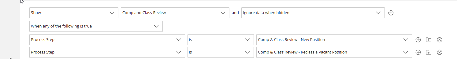

That's what I found as well, activities need a unique name.  So, for my field rule to show a field when process step is Comp & Class Review.  I'd need to add additional field rule conditions for that process step that goes to that team but with a unique name for each sub-process. Which I was hoping I wasn't going to have to do as the Comp & Class team would participate in all 12 subprocesses.
I'm going to re-think my process design and see if it is better to have dozens of field rules and field rule conditions or just move everything back to the main process and scrap using sub-processes.
