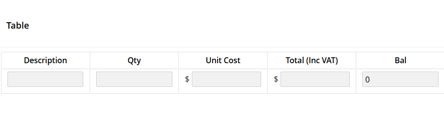

A form contains a Forms Table with multiple items (each row represents one item).

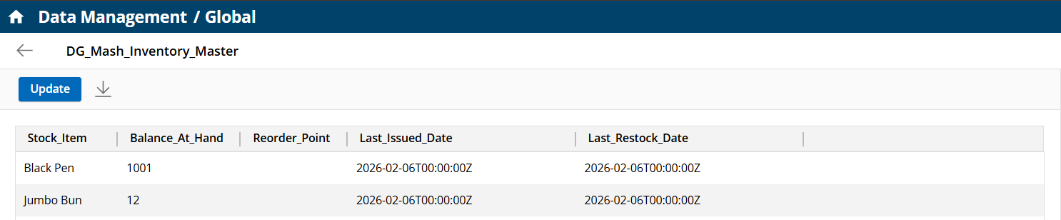

I would like each row in the Forms Table to be inserted as its own row in a Lookup Table when the form is submitted.

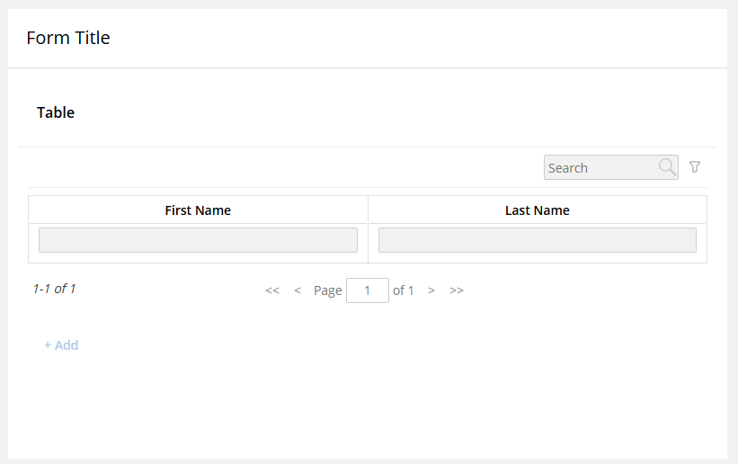

This isn't immediately intuitive - I needed some extra time with this!
If I understand what you're trying to do it does work. I'll work backwards from the lookup table.

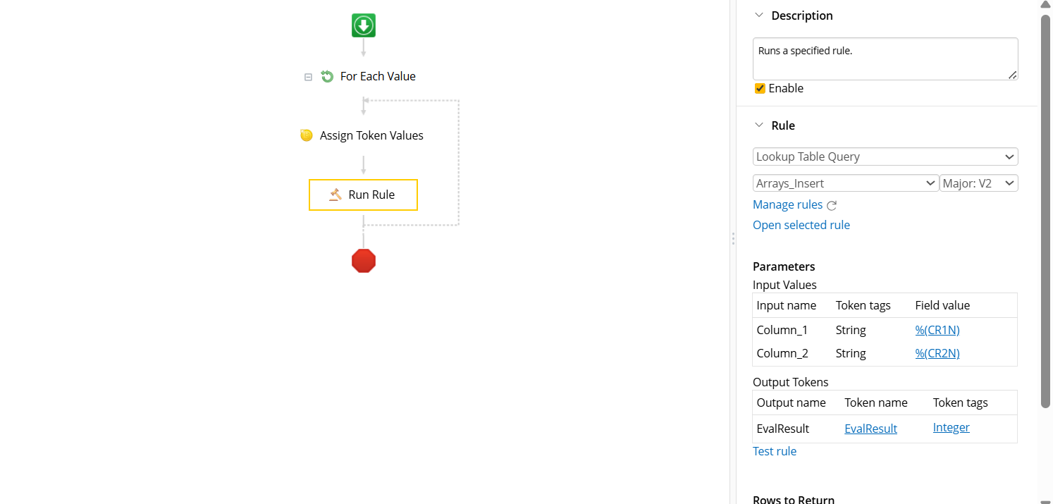

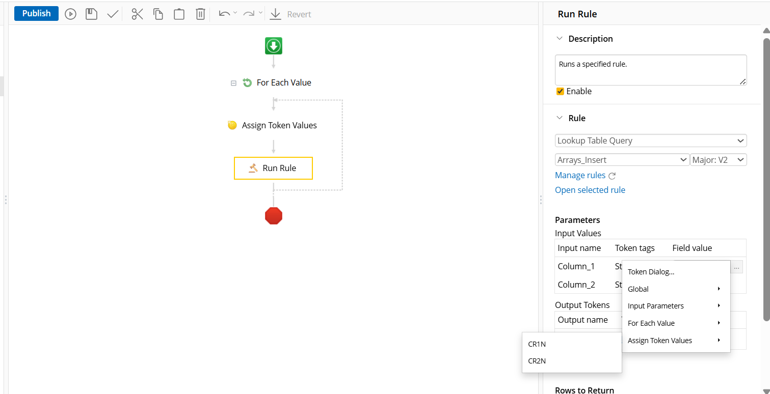

Create your lookup table. Create an Insert rule.

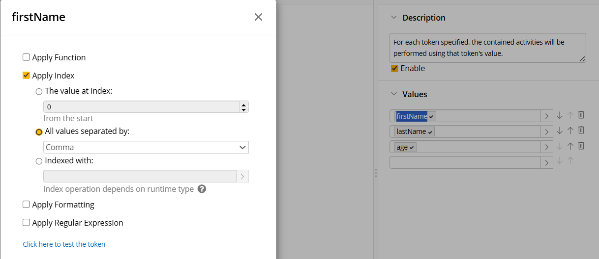

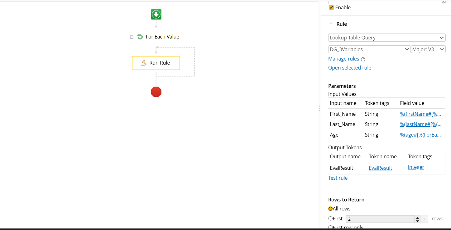

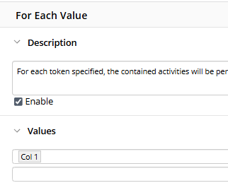

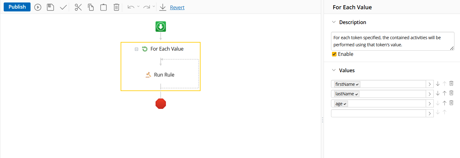

Create your workflow. Add a 'for each value' with a 'run rule' inside the iteration. I had two value in each of my rows so I added them in the 'Values'. It's really important to get this part correct; there are a few parts to this. Here's the workflow:

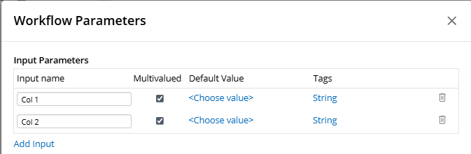

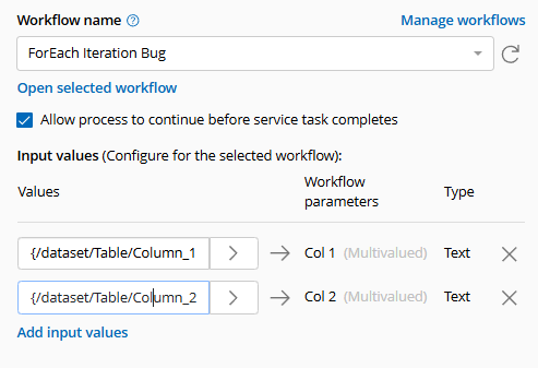

But first...the workflow needs input parameters. Parameters need to be multivalued.

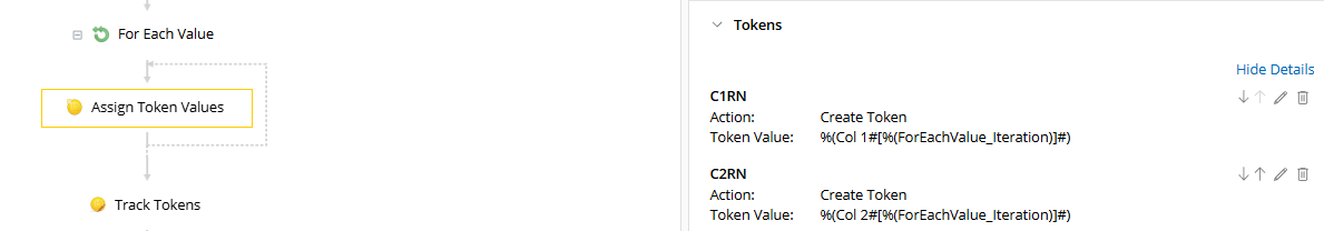

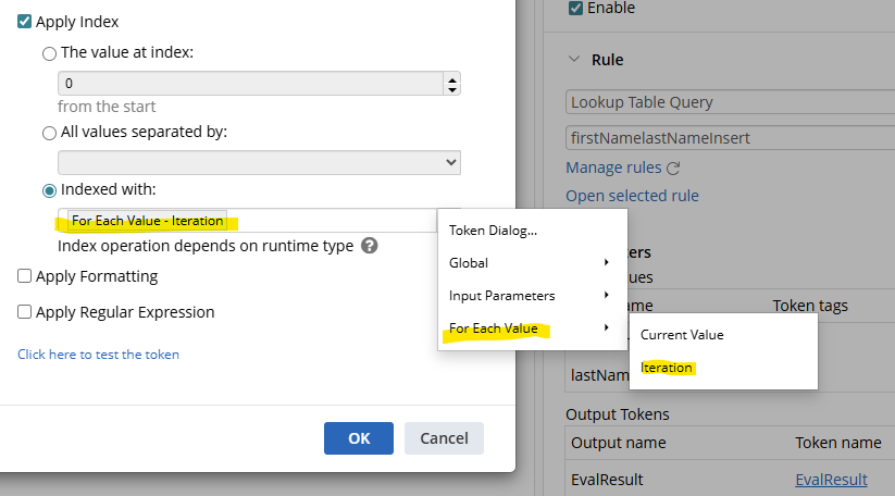

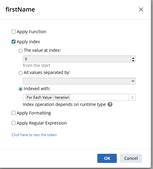

In the "Values" of the "For Each Value" activity be sure to apply an index with "All values separated by a comma".

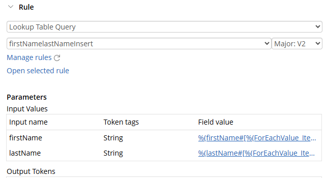

In the lookup table query "Run Rule", which is actually an Insert, set up your parameters like this:
Each of the Input Values needs an index:

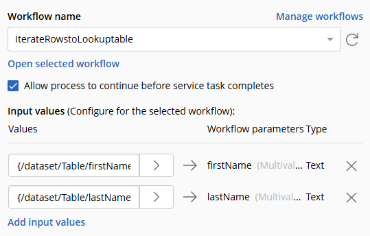

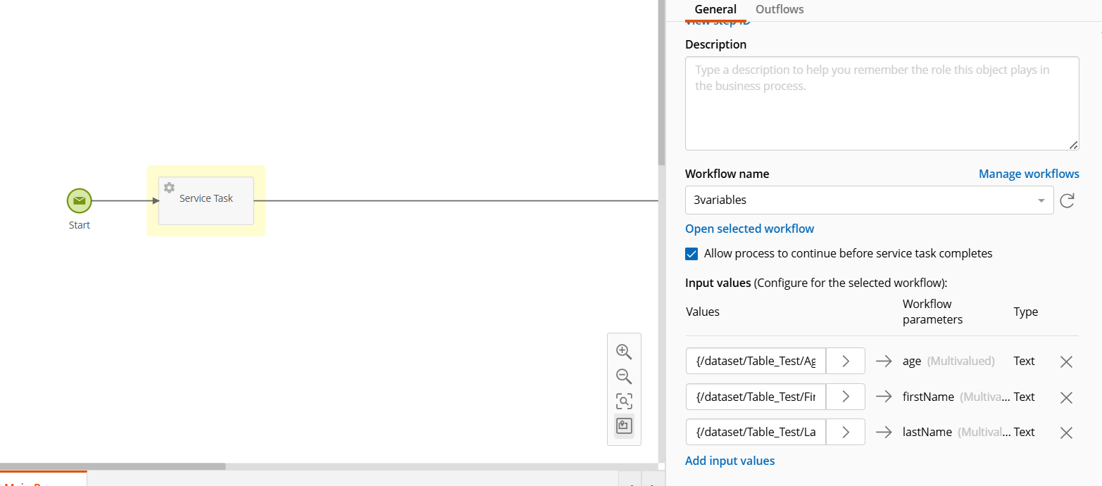

On your Business Process you need a Workflow Service Task

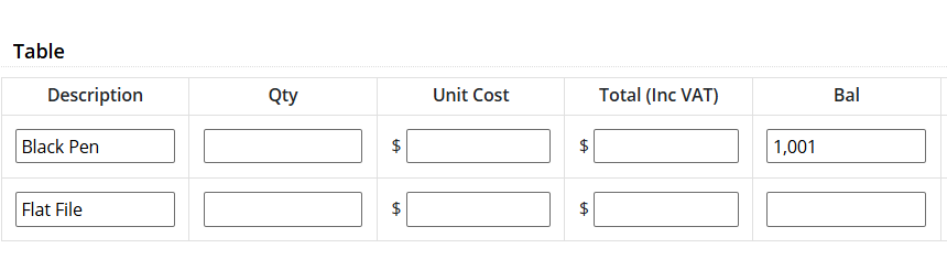

Here's what the form looks like:
Maybe I missed a step. Let me know! But this should get you going.
replied one day ago
This is the solution. Well written. Form tables/collections are just multi-valued fields when sent to cloud workflow. You recreate the rows using the index function as shown here.
