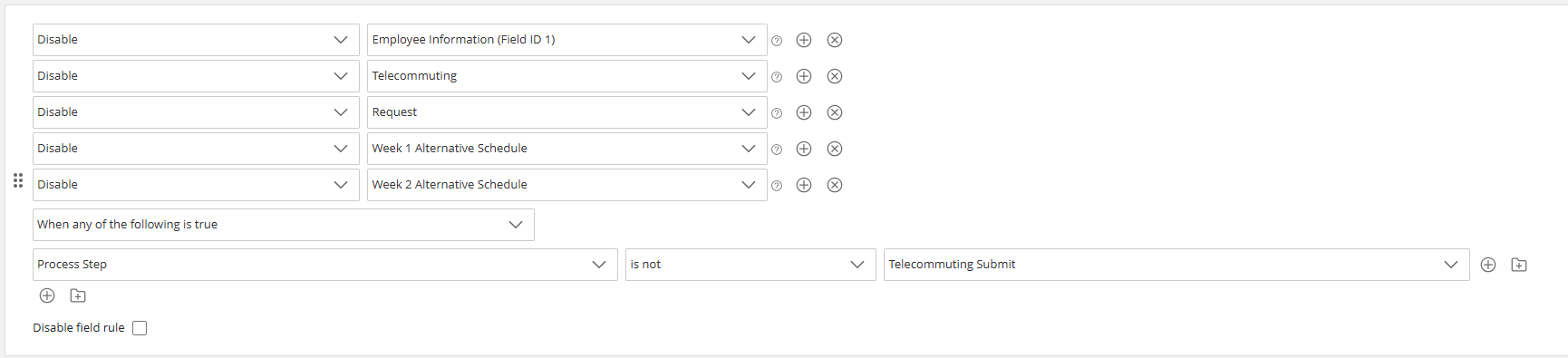

You can do this with Field Rules.  If you disable the field at a certain process step or process stage it will make the field read only.

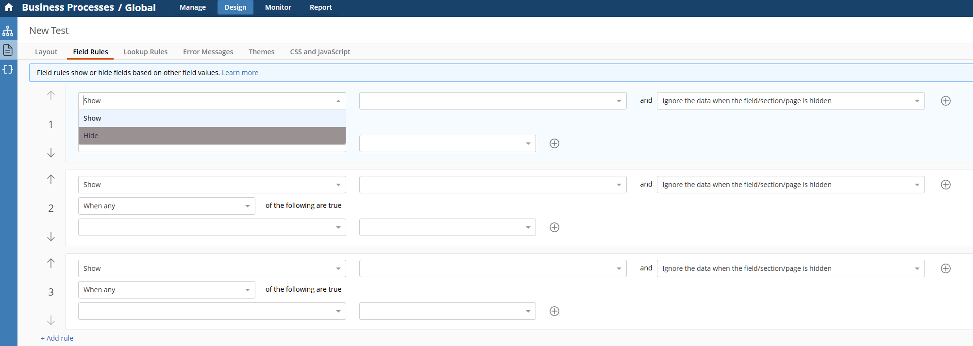

replied on January 29
My Field Rules page looks a bit different. I only have the option to Show or Hide. Is it possible I'm looking in the wrong place?

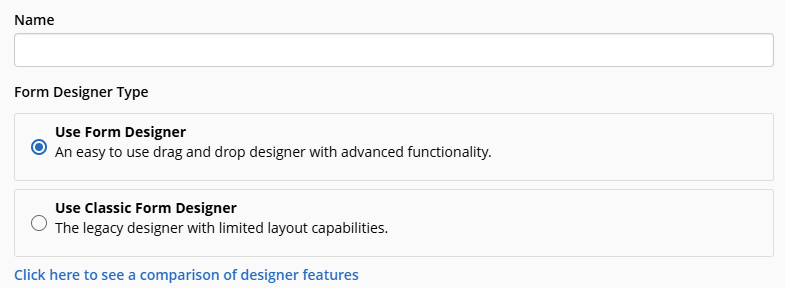

Looks like you are using the Classic Designer.  You will want to use the default Form Designer.
Thank you! That did the trick.
