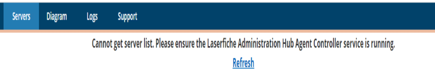

asked on January 27
What do you do if you see this message on the Servers tab but the service is running? Can we get more informaiton?

replied on February 23
It's an object reference error. Someone created a variable and forgot to set it in the code.
Object reference not set to an instance of an object.
   at Laserfiche.AdminHub.Core.Cache.LFDSRegistrationCacheService.GetServerRegistrations(Boolean extendExpirationTime)
Can we get the full stack trace for the error?
Caught exception: System.NullReferenceException
Message: Object reference not set to an instance of an object.
2026-02-18 08:32:32.6201||ERROR|AdminHubLogs|16|--- 2026-02-18T16:32:31.7944530Z AHWebContext started.
[+444ms][ERROR][Thread-16] An error occurred while sending the request.
Stack Trace:
Caught exception: System.Net.Http.HttpRequestException
Message: An error occurred while sending the request.
   at Laserfiche.AdminHub.Core.AgentController.AgentControllerApiClient.ExecuteUnderWindowsContext(Action action)
   at Laserfiche.AdminHub.Core.AgentController.AgentControllerApiClient.<GetAgentRegistrations>d__5.MoveNext()
--- End of stack trace from previous location where exception was thrown ---
   at System.Runtime.ExceptionServices.ExceptionDispatchInfo.Throw()
   at System.Runtime.CompilerServices.TaskAwaiter.HandleNonSuccessAndDebuggerNotification(Task task)
   at Laserfiche.AdminHub.Web.WebAPI.AgentRegistrationController.<Get>d__4.MoveNext()
Inner exception: System.Net.WebException
Message: The underlying connection was closed: Could not establish trust relationship for the SSL/TLS secure channel.
   at System.Net.HttpWebRequest.EndGetResponse(IAsyncResult asyncResult)
   at System.Net.Http.HttpClientHandler.GetResponseCallback(IAsyncResult ar)
Inner exception: System.Security.Authentication.AuthenticationException
Message: The remote certificate is invalid according to the validation procedure.
   at System.Net.TlsStream.EndWrite(IAsyncResult asyncResult)
   at System.Net.ConnectStream.WriteHeadersCallback(IAsyncResult ar)
[+824ms][ERROR][Thread-16] AHWebContext operation successful.
replied on February 24 • Show version history
Hi Chad,
You may ignore the NullReferenceException error, it is a known issue(644685) but it won't affect the site loading.
The error on the page should come from the second error, AdminHub site complained about connection error with Agent Controller (default port 7055).
 Please check what certificate is binded on 7055 and change to one that trusted by the server. AdminHub Utility ("C:\Program Files\Laserfiche\AdminHub\AgentController\Laserfiche.AdminHub.AdminHubUtility.exe") can be used to update the Server certificate used.

They opened this utility up and it was already set with a valid cert. I think the installation prompts you to do this from the start.
Yes, it will ask to configure the cert for Agent Controller. However, the log shows AdminHub Site cannot establish SSL connections with Agent Controller. What is the certificate look like? Is it a wildcard certifiacte? The certificate should match the Agent Controller's FQDN name configured in the utility.
replied on February 25 • Show version history
Ok I see. They were using the host name for the machine rather than the certificate domain. They updated to the domain in the certificate and now they get this error

And to clarify the obvious, the domain does resolve to the machine's local IP address and not some other machine.
replied on May 26
Getting more and more reports of this same error from other clients. Just looked at another one where no errors are being logged to the programdata folder.
replied on November 16
Did you ever find a resolution for this? If so, could you share what worked and which version/build you were using? Even a workaround would be helpful for others encountering the same issue.
