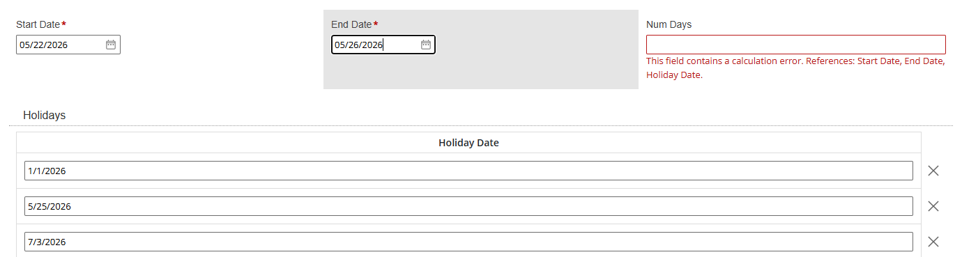

I found another post that seems to indicate that I can pass the holidays list from a table. I've tried doing that with a Forms table populated from SQL Server, but I'm getting an error. Got any suggestions?
Here's the formula:
=NETWORKDAYS(Start_Date, End_Date, Holidays_2.Holiday_Date)
And here's the error (which showed up as soon as I selected the Start Date:
replied on January 26
It turns out that the Holiday Date field needs to be a date field, and not a single line text box. The formula now works.
