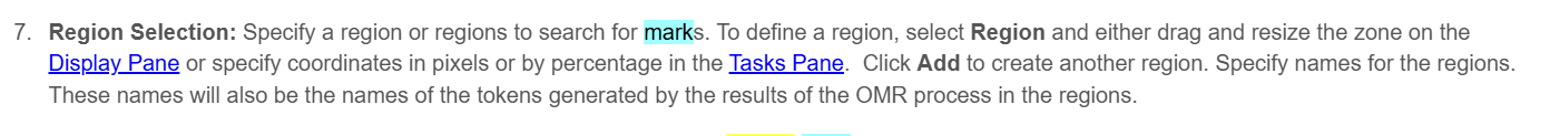

The documentation for region selection is very bare bones and does not discuss how to use the sample (green) zone.

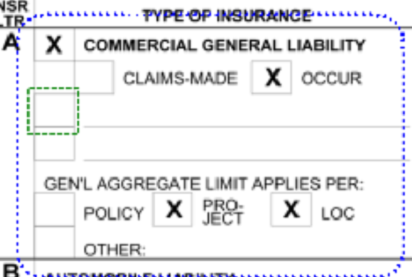

I find that if I put the sample zone around a marked example it only finds other marked boxes
However then it thinks that any marked box is "not marked"
So I tried placing the sample zone over an unmarked box but then I just get "No regions found"

What's your master form look like? ORM only finds checks that not exist on master form.
replied on January 27
It currently looks the same as what you see in the screenshot, with many left unmarked. I am requesting a blank master form as well.
I jumped on the Webinar for help and Elayne helped show me that I need a new blue and green zone for each mark. That does seem to work. I was trying to do a blue zone around all the marks and a green zone around 1 sample mark expecting it to find all the markable areas.
