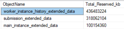

Holding all this data forever is causing an unhealthy amount of storage needs
Update: It seems that even with all the boxes checked Forms keeps almost all the data in history anyways. We opened a case, 24508, in January and it is now April with no resolution. This means Forms databases will grow infinitely.
