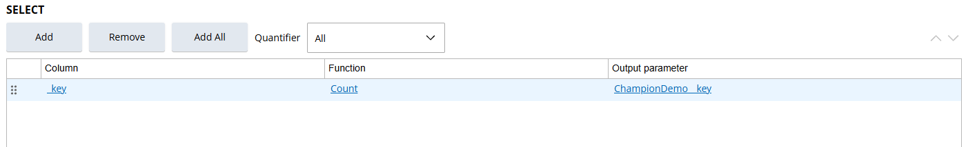

I definitely recommend the second lookup approach. For using a second query, the select should look like the following image. The where should just match what your other query is doing so you get identical results back
For JS make sure you are asking AI to use the LFForm object only because that code only works for classic forms. Regardless, the lookup event does not give you the resulting rows object and the code shows looking at a form field so implies the form was filled with a count.

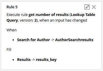

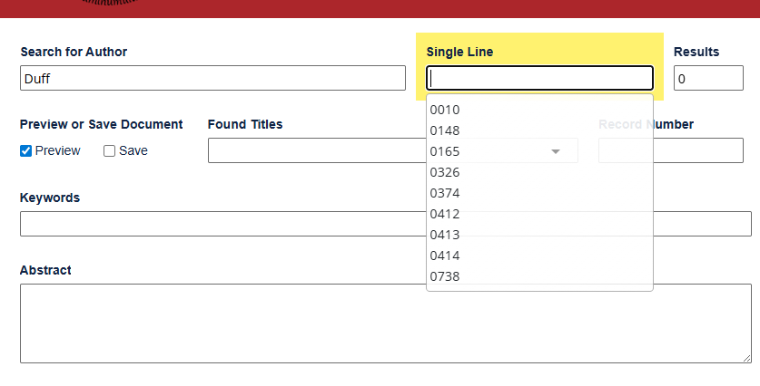

I think I am missing something. When I preview or run the form I get a list of results 9 numbers which do not seem to correlate to entry number or number of entries.

replied on January 7 • Show version history
If you want to show how many results there are from the item selected in the single line you should have two rules:
Rule 1: Find Entries by Author = select X columns (whatever you want to be selectable in that single line) where author = Y
Rule 2: Find Entry Result Count by Author and X = select count of _key where author = Y and "whatever you want selectable from rule 1" = Z
Rule 1 fills the single line, and rule 2 fills the results when something is selected in the single line populated by rule 1
If you want to see how many results are populated by the lookup populating the single line you'll want these two rules:
Rule 2: Find Entry Result Count by Author = select count of _key where author = Y
Rule 2 should populate just a single value regardless of whats chosen from the single line.
Pro tip: if you want to do both, just make three rules Rule 1.1, Rule 1.2, and Rule 2.2!
Hah, got it, . missed changing the function to count.
Works now, thank you so much for your help.
