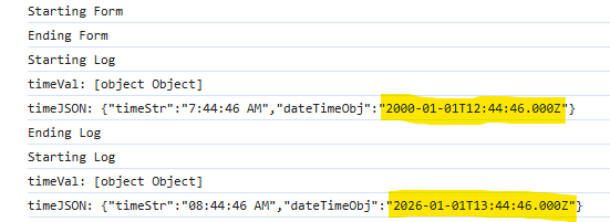

I have found that when I get the field value after the field has changed, it includes the dateTimeObj value/property in the returned object.  I then found that the dateTimeObj value/property is different when set though code than when it is set manually through the field on the form.  Below is from the DevTools console and it shows both when the field was set through code and then again when I manually changed it.  Notice that when I set it with code, the date is 1/1/2000, but when I set it through the field, the date is 1/1 of current year.

I'm not sure what the expected value type is supposed to be. It is odd that you need the timeStr but you can't submit the form if the field doesn't have the dateTimeObj (which isn't constructed internally when given just the timeStr.
This works though:

I do not know what was wrong with my timeStr formatting, but it would not submit even with the dateTimeObj.  I was just adding that because it was being returned when I get the value of the time field after it is changed.
Interestingly enough, the returned value from getTimeValue also includes the dateTimeObj but formatted differently than what is returned from the field after being set.

the datetime obj one just needs to be a string that can be used to construct a date with new date(d.toString()). There are a few supported strings/numbers that can be used here. The date itself should be irrelevant to your use case since there is no date associated with the time field.
You could update the getTimeValue function to support a date as well so you could use it for date, time, and datetime fields all in one
