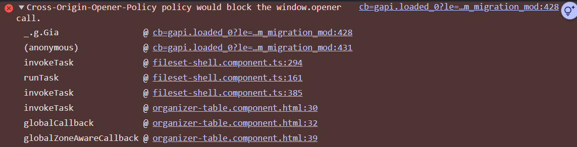

I recently updated my Google Calendar Events script to use the newest GIS authentication method required for newly created apps on Google Dev Console and it was working great. I built the test form sometime late last year.
Just went back in to test it and it was not working, throwing an error about Cross Origin when trying to authenticate.
I asked ChatGPT why I was getting this error now and it said
When CORP* is present, Chrome automatically applies popup isolation rules that can break Google OAuth popups in certain contexts (iframes, redirects, or strict sites).
This is a Chrome behavior change, not your code.
👉 Result:
Google Identity popup can’t communicate back → authorization fails.
Why it worked before
Chrome recently tightened enforcement around:
• CORP
• popups
• embedded contexts
Older Chrome versions were more permissive.
No code changes required for this to start failing.
*CORP is short for Cross-Origin-Resource-Policy and this is in the headers of Laserfiche Forms on LF Cloud.

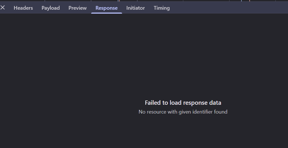

Using redirect from Cloud does not work in our system. It says canceled for the status when you reach the redirect page and sends you right back without asking to authenticate.
Under the response tab it always fails to load the response data so we can not see why they sent us back without authorizing us first.

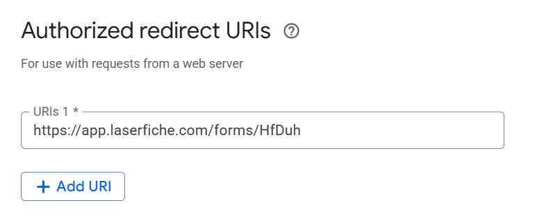

We do have the redirect URL allowed in the console

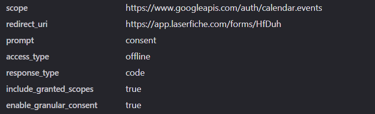

Here is the payload from the canceled request

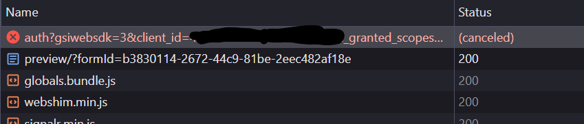

The console remains completely empty. The only error is in the network tab showing a status of (canceled) with a red X

Am I missing an error somewhere in the network tab? I just see the red X and the (canceled) status. If I mouse over the red X or try to click on it I don't get anything.

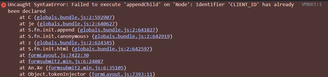

Their official code works for you? I moved away from it to use a chatGPT version when I started getting the following error. I reviewed their code to make sure there is no append function on the variable CLIENT_ID which is set as a constant to begin with. It should just be holding a string of characters. Because this error was completely illogical and the chatGPT version worked I switched.
replied two days ago

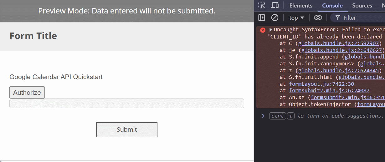

That error doesn’t happen when you preview the form. It happens in the designer because it keeps reinstantiating the code so it tries to redecorate the variable
For me I only see the error in the console after choosing to preview, but before I authenticate. I can click authenticate and the window pops up allowing me to choose my account, but it still displays this message in the console after I finish trying to authenticate and it does not show the add calendar button.
replied two days ago • Show version history

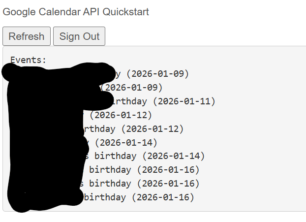

I was able to get a list of events from my calendar. It did throw errors and i'm not entirely sure why. It does seem to be instantiating twice erroring on the CLIENT_ID variable you mentioned too as well as the CORP error. But as you can see below, I was able to get it to work.
NOTE: I made the custom buttons type="button" because it was otherwise submitting the form
<p>Google Calendar API Quickstart</p>
<!--Add buttons to initiate auth sequence and sign out-->
<button id="authorize_button" type="button" onclick="handleAuthClick()">Authorize</button>
<button id="signout_button" type="button" onclick="handleSignoutClick()">Sign Out</button>
<pre id="content" style="white-space: pre-wrap;"></pre>
I just tried your exact code, but with my creds. It is actually re-throwing the error about CLIENT_ID each time I click Authorize. The popup comes up as it always has for me, I choose to continue with my account and it closes without error, but notice how no sign out button shows up and nothing is listed in the content box with no failures in the console.
Check your buttons, I forgot I made a change there they're type="button" otherwise they are actually submitting the form. its hard to tell but the form is refreshing when you click authorize.
Hey it worked! I would rather use the official script for sure, as I have used it for 10 years now. Only recently did I switch after it stopped working and I could not work through it, as of last year. But now it looks good, so I will try to work with this. Thank you!
And the pop up is working! Which answered my original question if it really is true that a pop up is impossible with modern browsers on sites that don't have the same-origin-allow-popups Cross Origin Header.

Ya I could not get it to NOT do the popup haha. I might try to get this to work in the modern designer by empower too.
Was going to try tackling the modern designer version next, but I think there might be some restrictions on the Custom HTML objects in that designer that could be a problem if I remember right.
