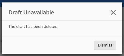

Forms v11 and v12 Save Draft does not show
asked on December 17, 2025 • Show version history

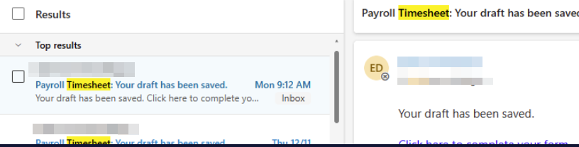

I get a report about this happening about once a month by some unfortunate user that had it happen to them. I could never get any details about because they submit again a move on with their lives.
This time i got a a pretty good clue. This user had an email sent to them with the draft url in it to return to the draft. I had her fwd me the email. It contained this URL:
OUR-FORMS-SERVER/Forms/form/resume/2908/888839
2908 = form_id
888839 = submission_id
I saved a draft and traced it back into these Forms database tables:
  • [cf_submissions]
  • [cf_form_submissions]
The submission_id in the above URL does not exist in either table when my test submission_id does exist.
FYI, I have looked at the drafts tab in Monitor for the specific process. These drafts are saved on the very first form before any formal submittal. The draft for the user mentioned above does not exist. If I go to the URL, I get his message:
I am looking for other ways to troubleshoot this before involving my VAR if possible. I'm also looking for a better way to understand how the draft data is stored and if it gets deleted once submitted or is it archived anywhere. Any light any of you can shed would be helpful. Thank you friends!

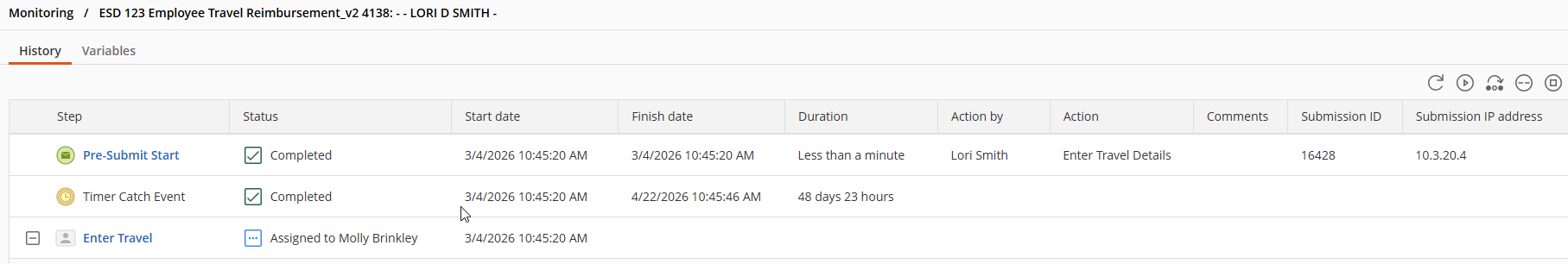

I now have additional information to share on this. I have a user that saved a draft but cannot retrieve that data.
Notice the matching BPID (4138) as the above instance:

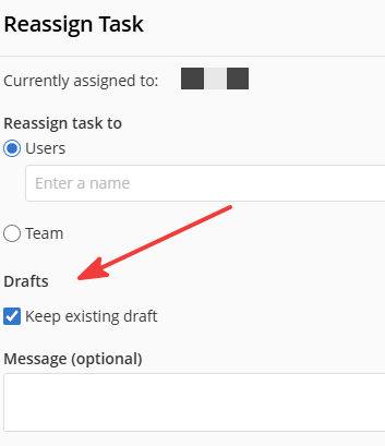

If I reassign this to myself and check the checkbox to save draft data, it is blank. This matches the description of the problem from the user (draft data does not save).

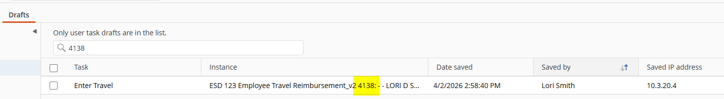

Additionally, I have a query that pulls draft data from the Forms database. I can see the lost data there. The bpid shows there.
I have proof it saved the data but the form cannot retrieve it.

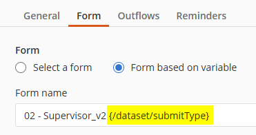

Ok final update on this. This gets nerdy real quick so hang in there.
The issue centered around the form getting set on the step with a variable.
here is an example of that:
What appears to have happened is this:
1) User saved a draft (not starting event)
2) the step was updated (and process saved ) to use a different non-variable driven form. This broke the connection to the draft. Some time after this, the form was returned to being variable driven, but the connection to the draft remained broken.
3) User returned to draft, saw no data and freaked out. The data was still there but inaccessible. Much drama ensued ha ha.
We could see the data in the database so we knew it was not lost. LF Support provided an update query to reset the form name to match the variable driven form name. The form could be opened successfully and the data showed.
There is no evidence of who changed the form name. I was doing a ton of troubleshooting in there due to the slowdown of performance after upgrading to v12. I'll assume I made the change not knowing the impacts.
The lesson learned here: changing the form on the process can break user's drafts when the form is set via variable. So proceed with caution.
