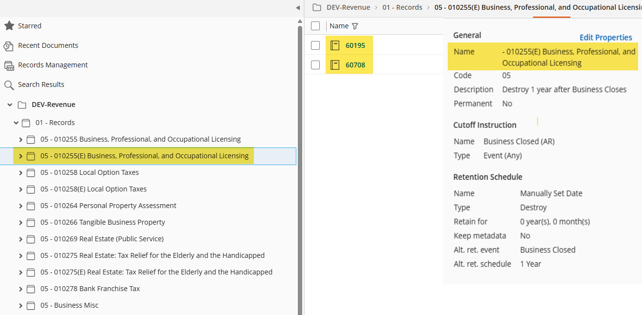

It seems that this should be very simple, but every attempt I have made to create syntax that will provide the desired results have failed.
I need a search syntax to use in Workflow that will return the record folders that are part of a particular record series. I have set up an example in our development environment. In the image below, I would need my search to return the folders named 60195 and 60708 by searching for folders that are in the record series you see listed. I either get only the record series itself as a result (despite using Type="F"), not the record folders, or I get no results at all. I've tried using wildcards, using and not using the code as part of the name, etc.
replied on December 16, 2025
Try to use "R" instead of "F" in your type syntax. That should get you record folders rather than "regular" folders. For example: ({LF:LOOKIN="\Record series you are looking in"}) & {LF:Name="*", Type="R"}
Hope that helps!

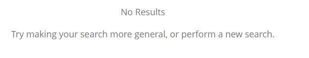

Thank you for your reply. I get no results using {LF:Name="*", Type="R"}
