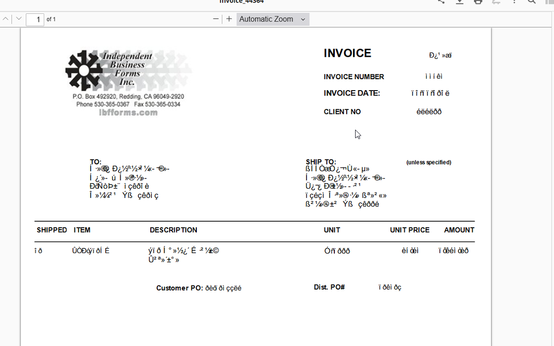

I have been running into this situation a lot, and it kind of feels random.
Some user will get a hold of me to tell me the PDF looks funny. Like this.
If they download the pdf and open it in another program like Reader or even Chrome, it looks fine.
If someone else tries to open the pdf on another workstation, sometimes it works. So it does seem like its a local computer issue.
The question would be, how do I troubleshoot this? There are no concerning errors in the browsers and even in the elements when I do the inspect. I have had my helpdesk try and update their Adobe Reader software and other things with no luck.
What else can I try and has anyone else run into this?

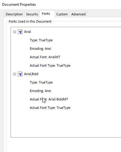

This is what Adobe is showing me.
If Adobe is swapping fonts, how would I figure out what it is exactly? If Adobe can swap out fonts, why can't the web client do the same?
replied on December 15, 2025
One thing that screenshot shows is that the fonts are not embedded, which is kind of the root cause. In the pdf I'm looking at, the fonts say "embedded subset". As for Arial, I'm not an expert but I see on my computer that I have both "Arial" and "Arial Rounded MT" (as well as "Arial Unicode MS"), so it certainly seems possible for users to have "Arial" installed but not have the specific, correct font available. Your document seems to request the "MT" version.
As for why Acrobat is more adaptable, the short answer is that it knows all the fonts available to it and can choose one to use as the next-best option. As far as I know, this is functionality provided by Acrobat-the-application and is totally independent of PDF-the-file-format. PDF doesn't have the notion of fall-back fonts the way html does - the designer specifies the exact font they want to use.
Web-based renderers have no idea what fonts the end user has installed and so don't have the information to make that sort of decision. There isn't that fall-back list that they could tell the browser what to do if the specified font is not available.
