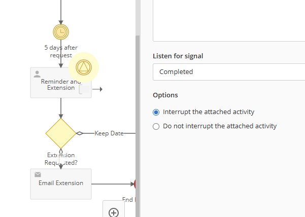

Does this look good? I'm not sure if I need to link it to an End event here.
replied on December 10, 2025
The timer would have to be attached to the task for the task to interrupt. I do not believe there is a way to interrupt a standalone timer.  You could use a gateway condition that skips the reminder email and ends the form once the timer hits based on a value in the form.
