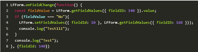

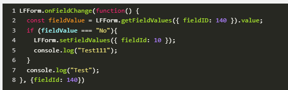

I've got a text field that I want populated based on the response to a radio button question.  The code I have is
fieldID 140 is the radio button.  When select "No" on the form, the if statement isn't kicking in.  I'm not sure what I'm doing wrong as I've gotten this code from Answers.  (I'm using the Modern Form designer.)

Line 4 you're not setting a field value, it should be
LFForm.setFieldValues({ fieldId: 10 }, fieldValue)
replied on December 3, 2025
I made that change, but it didn't work.  I don't think it's looking at the if statement properly because I'm not seeing the console.log("Test111").
This is what I see in Developer Tools:
replied on December 3, 2025 Show version history
I don't think the .value should be there on line 2.
LFForm.getFieldValues() returns the values, not the element.
  • If it is single-valued you get the value
  • If it is multiple (i.e., multiple fields, a table, etc.) you get an array

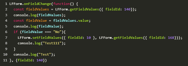

I'd add a console above line 3 with the variable fieldValue. Without seeing your form I don't know the context of fields you're working with but the console statement will show you whats wrong. If you remove the .value from line 2 it will log the entire field value returned so you know how to pull exactly what you're looking for.
replied on December 4, 2025

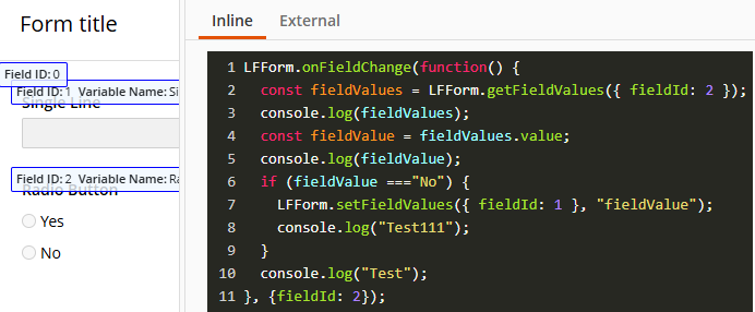

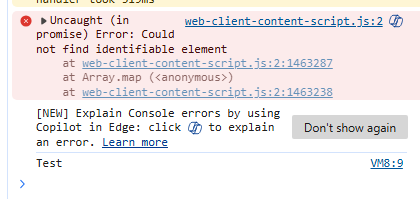

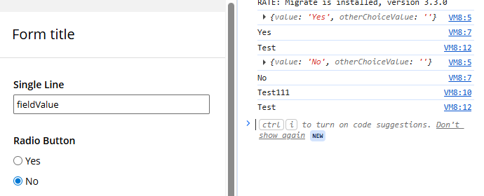

Here are screenshots from a test form with just a single line field and Radio Button and a hardcoded value to insert into the single line field.
And the results from first hitting Yes and then switching to No

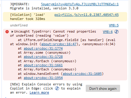

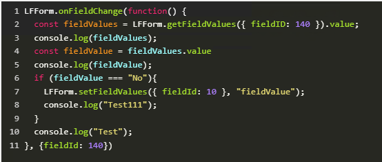

I copied your code, but kept my same fieldId's:
As a result, now I'm not seeing any of my console logs:
Ah well that makes it easy! you capitalized the D in fieldId on line 2 of the code
replied on December 4, 2025 Show version history
You still added .value which is going to return undefined
You don't need that part because the API method returns the values, not the element.
Also, line 4 is missing the ; at the end.
@████████ .value is still needed because radio/checkboxes return an object instead of a string. You can see the value returned in Bert's second screenshot
Also ; isn't needed in JS, I definitely recommend consistency and using it but it won't throw an error or stop code execution without it
@████████ I do not call .value on line 2.  Instead I get the object and then call .value on the object created by line 2 in line 4.
While the code may be shortened, then you need to adjust to use the correct variable.  In their version of my code, they are trying to call .value in line 4 on an object that does not have a .value method.
@████████ Good to know; that does make sense. Is that mentioned somewhere in the documentation?
Your code is correct, just slightly different than the original post.
And yes the return types are crudely documented on the setFieldValues not the getField values

Thanks peeps!  I got it to work with this code:
