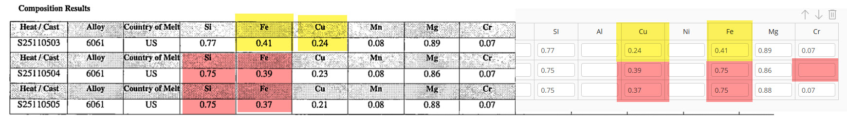

New to Smart Fields and testing various things. One interesting project is to pull line-item details from a table. In the tests I have run so far, the first line pretty much always returns correctly but the lower lines run into issues. Not OCR mis-read, but like data from one column being pulled into the field for a different column.
Has anybody run into this? Any ideas about a prompt or other change to do better on the lower lines? It's almost like ChatGPT runs out of steam after the first line and then doesn't work quite so hard.

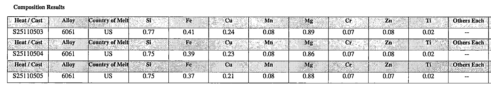

Original Table: from "Hydro Extrusions.pdf"

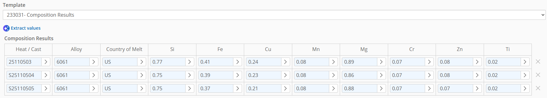

Extraction Results:

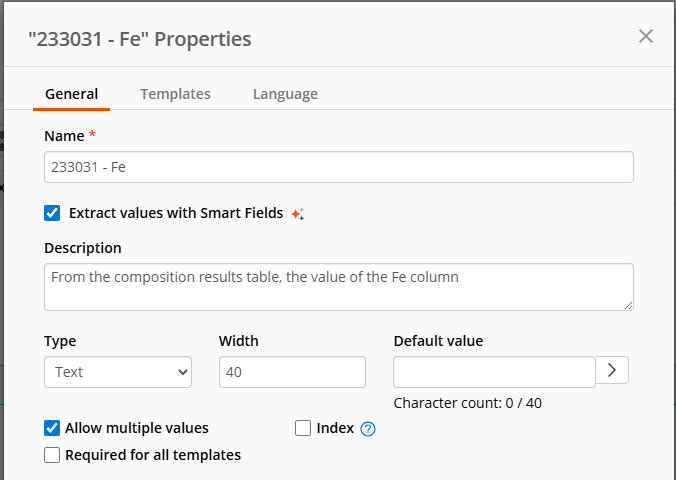

Field Definition for Fe column:
With the table extraction enhancements which are released, please see if you are able to get better results.

I'll attach 2 sample docs. The Hydro one is the one from the screenshot. Note that after the screenshot above I made a new template and tailored my prompts specifically for this 1 vendor, as opposed to 1 template for various different vendors, and it did do better but still missed that middle Cr value.
