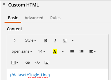

I'm sure someone smarter than me can chime in in terms of JavaScript, but here's how I would accomplish it without coding:
If you need the link to be clickable immediately/during the same step, you can use a Rich Text field.
If you just need the link to be clickable for the next step in the process, then you can insert the variable for your single line field into your Custom HTML field, using the variable as the URL as well.

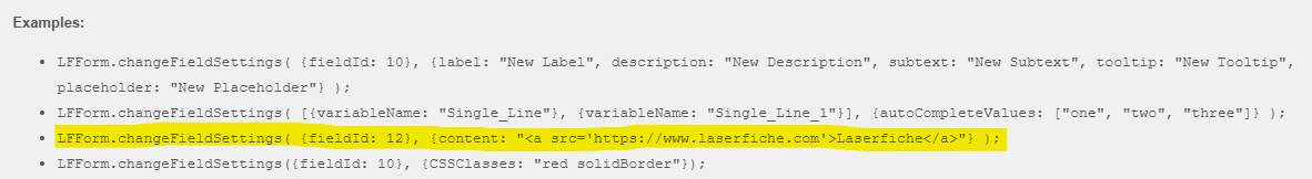

Custom HTML elements have no variable name because they're not "input" elements. However, you can still reference them by Id.
When you open the CSS/JS tabs, you should see the Field Id value in the top-left
once you have the id, just replace: { variableName: "UrlClickable" },
with: { fieldId: __ }

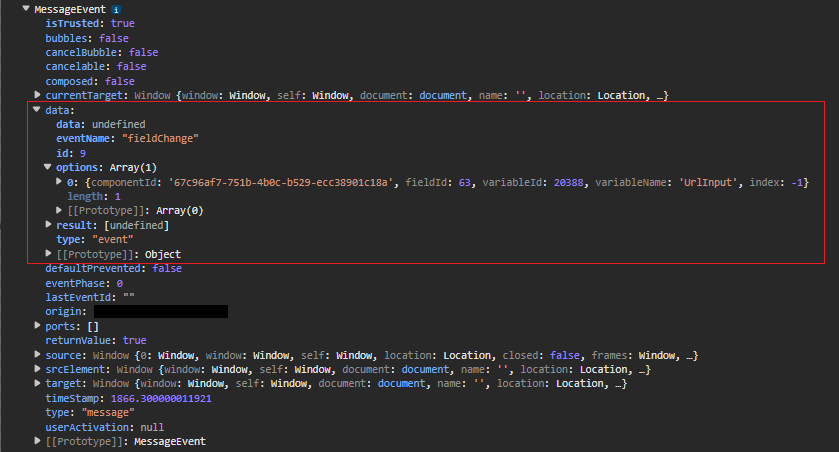

Interesting. When I log the event object to the console I'm getting this
replied on November 19, 2025
where are you logging event? Could you show the full code? that event looks like the main event passed between the form and the sandbox iframe.
Using this simple code
LFForm.onFieldChange(function (e) {
    console.log('event from change', e);
}, { fieldId: 2 });
I log:
I can do a little more digging to see if/when that changed in 11 to 12

You're right, I forgot to add the function parameter, and I referenced the variable as "event" so it was just referencing the main event.
In the code below, the "e" variable works correctly like you demonstrated, but event is also populated and what I was getting.
  console.log(event, e);
}, { variableName: "TestInput" });
Fun times with JavaScript scoping haha.
replied on November 20, 2025
ya definitely scoping fun there, fortunately nothing there that would need to be fixed from a security perspective, and unfortunately nothing fun there to use for customizations
