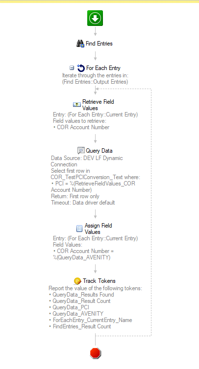

We could have a table where column A is system A account # and column B is system B account #. I've tested out running a workflow in our development environment to retrieve the current account number (A), query a table of fictitious account numbers (B), and update the field with the new account number. It works on a small set of documents tested.

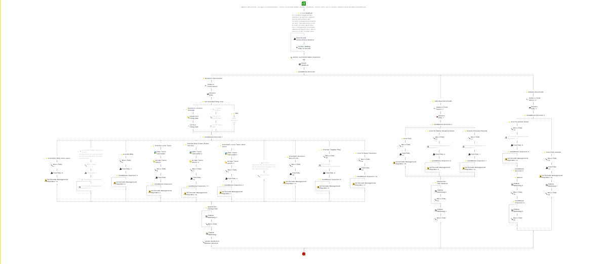

I attached the conversion testing workflow and a file that shows the number of branches on the autofile workflow, not that you can read the details, just to provide an idea of the number of conditional steps that exist.

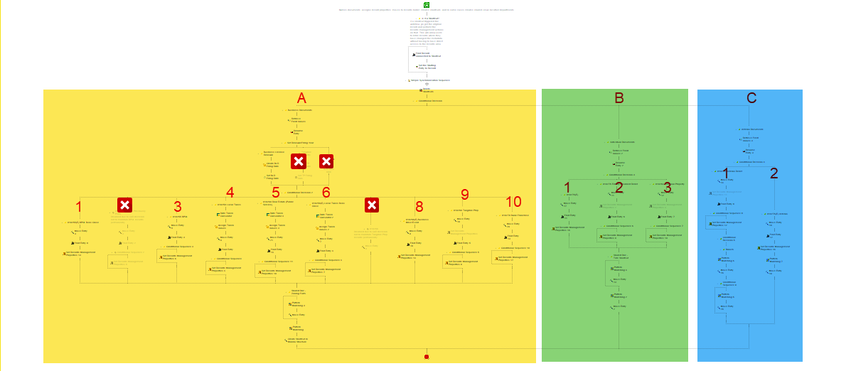

One good thing, if there is a good thing, is that I have everything that would apply to the numbered branches you see in their own records folders within the repository.  What you see with a red X is a branch that we have disabled, as there is no longer a need for it.
For example. I may have 9,000 docs that would meet the criteria for A-1 all together, 6,000 that would meet the criteria for A-3 all together, and so forth all the way down to C-2 where I could have 25,000.
So let's say I was working on reprocessing the docs in the records folder associated with group C-2, I could disable primary branch A, primary branch B, and secondary branch C-1 then process those that I know meet C-2 criteria so that all the work is following a vertical, vs horizontal conditional process.  Then follow suit with each remaining branch.
If the steps being taken in Workflow are all vertical, do I still have concerns with the volume of documents that would be selected to hit the workflow at any given time?

Because all of your branches/logic are constrained to a single workflow you will hit a concurrency limit of 4 at a time. I can't quite tell what starts your colored screenshot, but I'm assuming its a metadata conditional starting event. This isn't necessarily bad, and would be needed if you also want to change metadata from the repository client to re-trigger the update workflow. For your large batch I would recommend copying the topmost branches that define A/B/C to the workflow that loops over the entries and queries the database for the new account numbers (I'll call this the main workflow). All you need is what gets it into either branch A/B/C you don't need the logic for branch 1-X. Then I'd make three copies of you colored workflow (I'll call this the filing workflow), so you'd have filing A, filing B, filing C. You can keep them as is, even though you already know if its A/B/C at the point its invoked its minimal overhead and you don't have to worry about breaking the workflow disabling stuff. Then in your main workflow you just invoke filing wf A, B, or C from within the condition making sure "wait for wf" is not checked.
Now you should be able to get roughly 3x the speed. If A is still 2x the other quantities that will be your slowest workflow to complete, but should still be a smaller number than your original amount.
Note: I'm assuming none of this filing touches the same entries i.e., two workflows potentially running at the same time trying to create the same parent folder. If thats potentially the case and the workflow isn't built to handle that I'd say just run it how you have it now (still prefer directly invoking instead of waiting for field change) and let it run over a weekend.

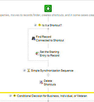

We do not OCR any documents in this workflow. Under normal circumstances, it is initially kicked off using a conditional starting rule to monitor for a document landing into a particular repository folder.
To enable this workflow to apply changes to documents that already exist in the repository where someone might change a field on a shortcut that requires it to run again, there is a step at the beginning that checks to see if it is a shortcut and will delete the original one. From there the decisions begin, is it a business, individual, or veteran account based on template. After that, depending on document type, all sorts of things happen.
I am going to paste pictures of the segments of the workflow, start to finish, for how one document might flow down through the business segment of the workflow.  p.s. I can't recall why the Simple Sycn Sequence was used, but it was for performance reasons and added by our solution provider.

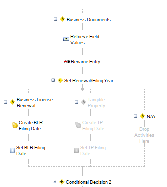

This next step needs to be cleaned up as now there is no condition, it just needs to create a filing date for all that hit that branch.

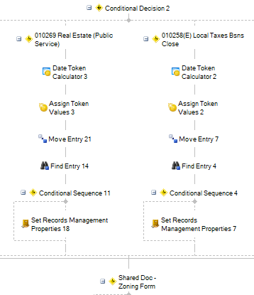

Next, we are looking to see, based on document type identified by a field in the repo, which retention classification it falls into, creating date tokens, routing it to a folder, and updating records management properties accordingly,
