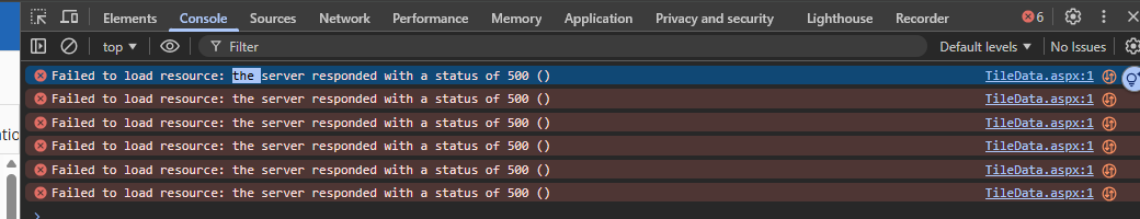

Has anyone experience the issue with WebLink, where it starts missing the tiles after viewing a few documents and eventually terminates the session and forces the user to log in again?
All I can see in the console log of the browser is the HTTP 500 errors (for the missing tiles) from the TileData.aspx.
Refresh the browser will reload the missing tiles, but this happens too frequently and quickly (after 4-5 views) that we suspect something else is at play here.
We have recently upgraded Weblink to version 11.0.2506.19. I don't recall this behavior in the last version.
Not sure how to troubleshoot for this type issue, any advice is appreciated.

think an update was supposed to fix that bug but am not positive. Hopefully it did. We encountered it a few years ago and the workaround we set up--and continue to use--is a scheduled task to stop and then start WebLink's app pool in IIS. Running that every 3 hours has worked for us.
If you go this route, you'll of course need to verify that it doesn't mess users up (causing them to re-login, for example) and figure out the timing. I will also note that my developer was insistent that we do not just use Recycle, as that doesn't always clear things out. It's better to stop the app pool and then start it back up.
