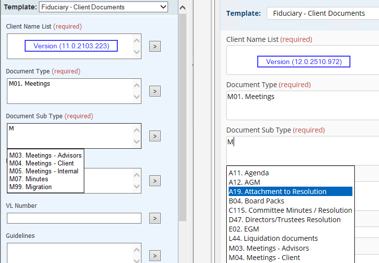

Hello - were looking to upgrade from version 11 (11.0.2103.223) to version 12 (12.0.2510.972), however during our testing we have found a bug with the dynamic fields not filtering correctly. Below is a screenshot showing the difference between the two versions - has anyone else seen this issue?

We have had a few users report that the LF 12 (Fall Release) Desktop Client does not treat dynamic fields the same way as it does in v11, so I'm assuming there are still some bugs to address.

Hi Jesse,
The issue does not appear though if you keep a PC on version 11 of the desktop client connected to a server version 12?
replied on November 14, 2025
Jacob,
Correct, if we use a LF 11 Client connecting to LF Server 12, the issue is not there.
