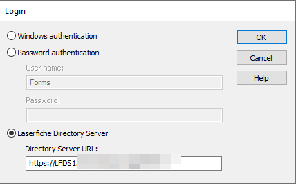

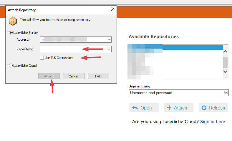

v12 2025 H2 seems to have a bug in it. My users now have to reattach the repository every time they need to go into it. It does NOT retain the setting to use LFDS for SSO. Changing the registry does NOT set this as default.
We have many unhappy campers. If this is a bug, I need to know an estimated timeline for bugfix if possible.
Can anyone else reproduce this on their end? If so, and you use SSO, beware this update!

replied on November 10, 2025
This was identified as a defect in Laserfiche Directory Server. Reference ID #622665. We're looking into a fix.
6 0
replied on November 13, 2025
Hi Miruna-
What configuration leads to this? Is it LFDS 12 and Desktop Client 12 using LFDS login (as opposed to Win Auth)?
replied on November 14, 2025
So far, it seems to be an issue with the HTML page that we embed for LFDS login, but i haven't gotten a full root cause explanation from the team. We'll be issuing an update to LFDS later this month for it.
