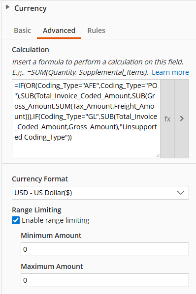

I have a currency field in the modern designer that I need to be equal to 0 and if not, throw an error. When I try to use the Range Limiting and set the Min and Max to 0 it doesn't seem to do anything. Is this supported?
replied on November 6, 2025 • Show version history
Playing with this a little more, I think the Range Limiting works when used by itself. I seem to have a problem with it when the field that has the range limiting set also has a formula. This is the formula I am trying to use with it:
=IF(OR(Coding_Type="AFE",Coding_Type="PO"),SUB(Total_Invoice_Coded_Amount,SUB(Gross_Amount,SUM(Tax_Amount,Freight_Amount))),IF(Coding_Type="GL",SUB(Total_Invoice_Coded_Amount,Gross_Amount),"Unsupported Coding_Type"))

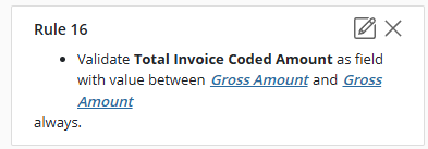

I was able to replicate the same issue when using a field rule to validate a field and have the range limiting enabled.
