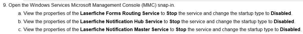

Thanks Angela, good to know it does work in this configuration.  I forgot to mention that part of my confusion comes from this guide on manually configuring a DMZ Forms IIS server in a two forms server setup that does not have a cluster component.  In it the last step for the "Standard DMZ Configuration: Two Forms Servers, One SQL Server" configuration, it includes stopping/disabling both Notification services on the Forms IIS server in the DMZ
Seems odd that in a non-clustered setup where Forms IIS and Forms Routing are split to two servers, that you would disable these on the IIS server but not with the same setup except the Forms Routing portion is also clustered.
