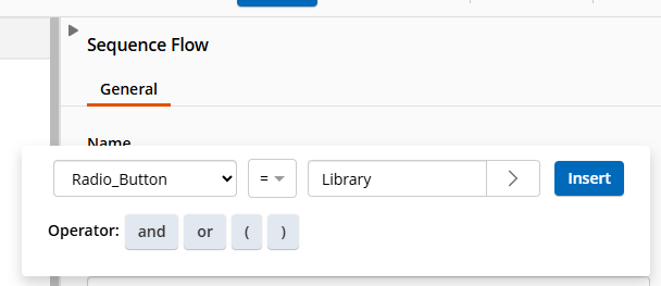

You should be able to set this up just using conditions on the pathways in your process diagram, rather than gateways.
Click on the pathway leading to "Send to April", then under Condition, select the process variable your statement is based off of, and enter Library in the criteria. Here's an example where my variable name is just Radio_Button:
It would look like this:
/dataset/Radio_Button="Library"
Then click on the pathway leading to IT & HR, and click the box for "This is the default outflow path".
Let me know if you have any questions and I can try to explain a little more!
