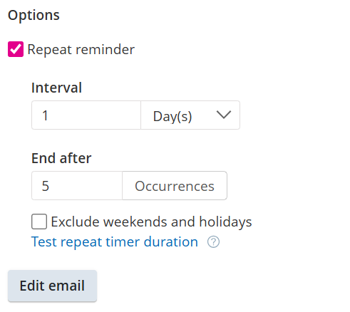

The way I understand it is that it will send a certain number of "occurrences" of the reminder. There may be a setting for that max number in some configuration that I'm not aware of. But, at least for me, that max number is set to 100.
So, there is no global default setting, it's a limitation set at the task level? Or there is a global setting and it can be overridden at the task level?
The only place I've ever found to set it is at the task level, when you are setting up the reminder.
It sure would be nice to be able to increase that number somehow...
What Jamie is showing is the setup in the individual task. The max limit here is 100. Logically, it would make sense that the default notification template in Config would max out at 100 as well. However, since it is multiple tasks assigned to the same user, the system would need to know what number each task was on. My email could have 5 tasks all assigned on different dates there for each email notification current total would be different.
