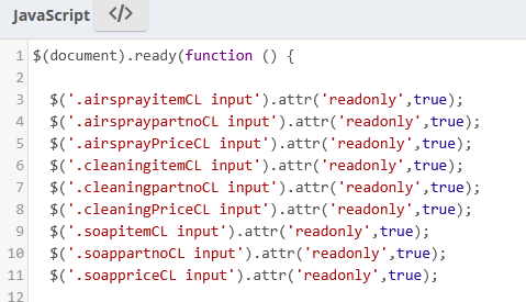

Sorry, that was just a copy from the referenced post. Attached is what my code (for one group) actually looks like.

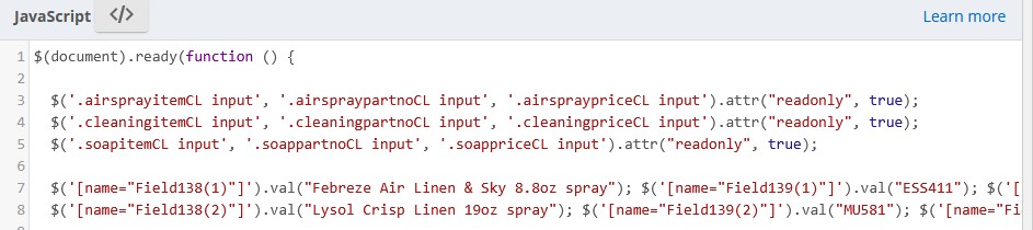

replied on October 20, 2025
That appeared to work! Thank you!
Apparently they had to have their own attribute.
More rows, but it works like it should now! I already had 350+ rows, adding more wasn't an issue.

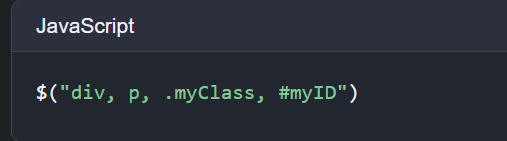

Oh you had too many quote characters in the original code. The way we reference multiple elements with jquery is with commas inside of the quotes, not outside of it. Always check the console for errors after saving new code.
Also you only need one line to designate a class that sets a field to readonly
 $('.read input').attr('readonly',true);
There are many redundant statements in your screenshot.

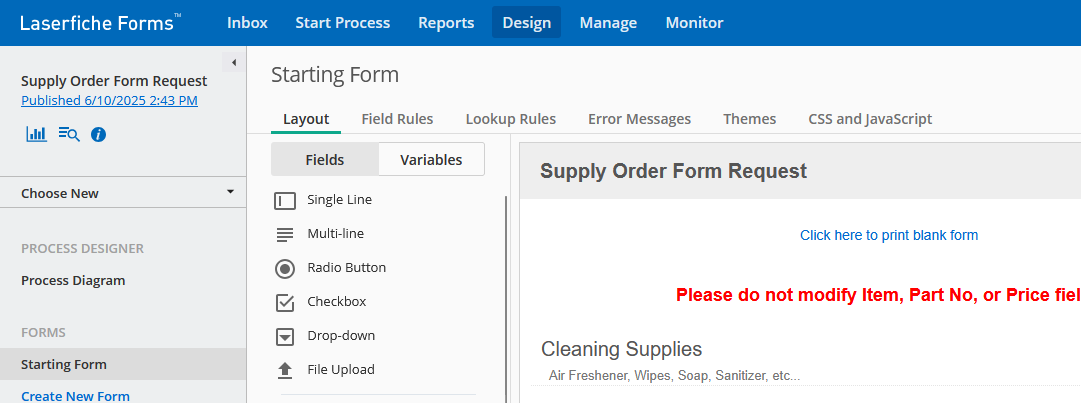

Are you using the classic designer or modern?
replied on October 17, 2025
I believe its modern, but not sure how exactly to tell.
Nope, that's Classic.
