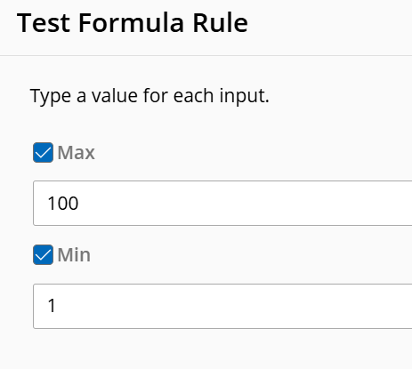

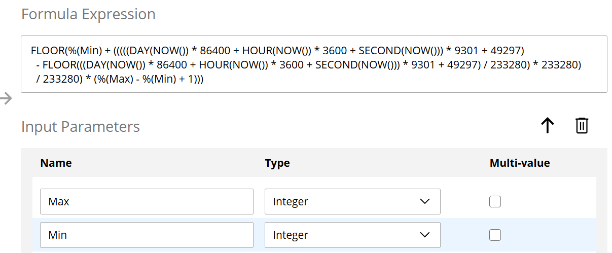

If you can sequentially number your rows, then you can create a Randomizer Formula rule to return a random row. Use the following syntax for the rule with a Min and Max input assigned. Then query the top row in your table before calling the rule to set the correct max row count value.
FLOOR(%(Min) + (((((DAY(NOW()) * 86400 + HOUR(NOW()) * 3600 + SECOND(NOW())) * 9301 + 49297) - FLOOR(((DAY(NOW()) * 86400 + HOUR(NOW()) * 3600 + SECOND(NOW())) * 9301 + 49297) / 233280) * 233280) / 233280) * (%(Max) - %(Min) + 1)))
