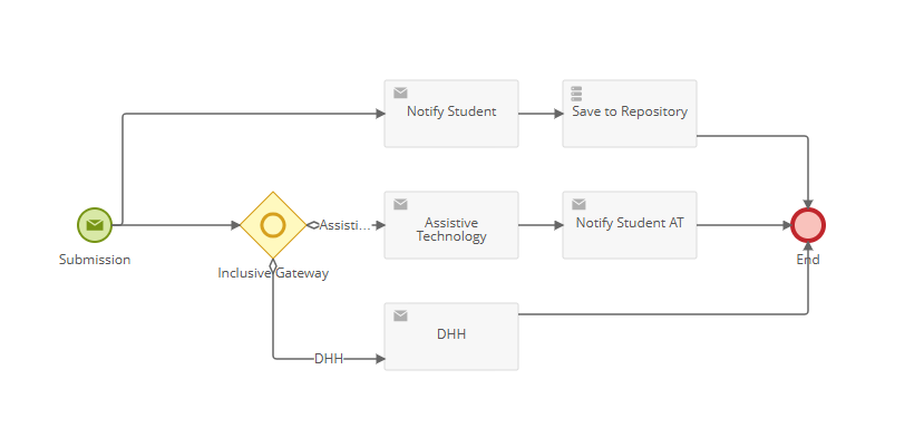

I am getting a process suspension error message that  Routing cannot be split to any subsequent branch.
The student is getting the notification email and the submitted form is also saved on the repository, so the process is "working". Not sure why I am getting this error message when none of the boxes under the Assistive Technology and DHH fields are checked. Here is the process diagram

What are your conditional rules on the gateway?

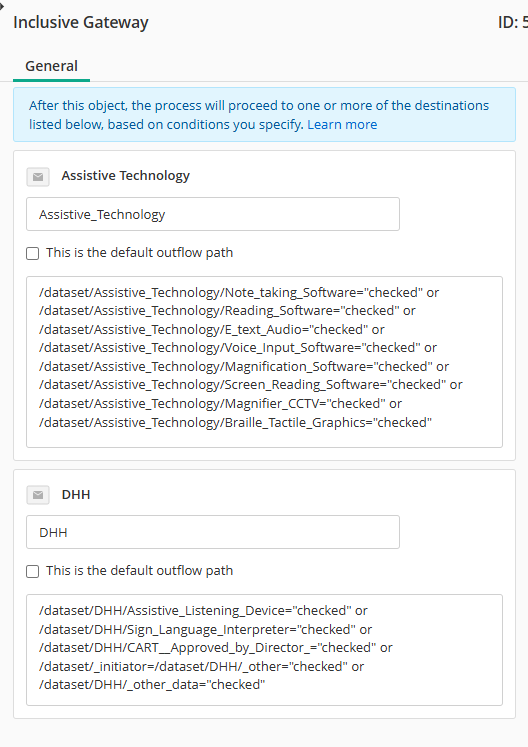

replied on October 10
You're getting the error because the gateway doesn't have conditions for none of the checkboxes to be checked.  An inclusive gateway acts as an and/or decision and the form submission does not match any of your conditions.

If you don't want either of the paths to be the default outflow path, create another path from the gateway to your End and put in conditions for that path where everything is unchecked.
replied on October 13
what would the condition be "not checked"?
!="checked"
replied on October 14
That is the condition I have for the Assistive Technology and DHH. I am getting the error when none of the boxes are checked
You aren't accounting for some possibility in your conditional rules. The solution is to define all possibilities and account for all of them in your conditions. This becomes easier by making one of them the default, which I strongly suggest, since that would've prevented this from ever happening to begin with.

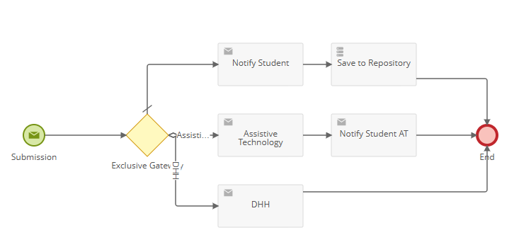

that's what I did previously but it did not work, apparently I was using the incorrect gateway. changed it to Exclusive and made one the default. think it is working now.. thanks!!

Unfortunately, it is still not working. What condition should I put so that when none of the boxes are checked, the process will still work?
replied on October 21 Show version history
You haven't made clear what the desired outcome is, so this is a guess:
The conditions for Assistive Technology should be when any of the Assistive Technology boxes are checked. The conditions for DDH should be when any of the DDH boxes are checked. The conditions for Notify Student should be default.
This is with the assumption that it should only be routed through one of these branches.

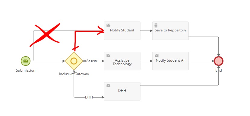

You need to move the Notify Student path so that is also comes out of your Inclusive Gateways and is set as a Default.  Like this:
Notify Student will always run because it is default.  This will avoid the error you have had when no paths were running.
Assistive Technology will only run when its criteria is met.
DHH will only run when its criteria is met.
Inclusive Gateway needs to run 1 or more paths, so you’ve had the error because no paths were valid - having a default path ensures there is always a valid option.
FYI - Exclusive Gateways will always run only 1 path, so default in that case is an “else” option if nothing else evaluated as true.  And Parallel Gateway runs all paths without evaluation.
